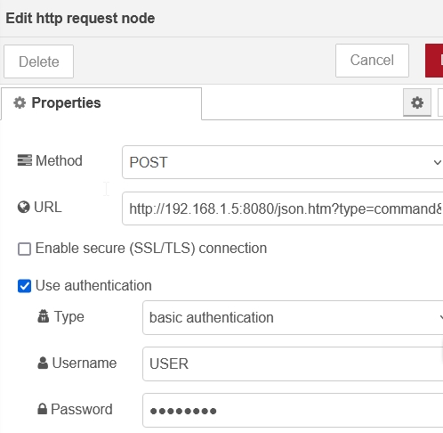

I'm not sure if it's a Node-RED problem or domoticz, but I'm experiencing an issue after removing 192.168.1.* from my trusted networks.
I want to do this because more users are accessing the WebUI.
When I paste this URL into my browser, it works fine:
http://192.168.1.5:8080/json.htm?type=c ... vvalue=100
In Node-RED, I use an HTTP request node with the same URL. It works when 192.168.1.* is included in the trusted networks.
However, without 192.168.1.* in the trusted networks, I get an error in Node-RED:
"<html><head><title>Unauthorized</title></head><body><h1>401 Unauthorized</h1></body></html>"
I do have the IP address of Domoticz/Node-RED (192.168.1.5) in my trusted network.
Do you have any idea how to solve this? I've read the wiki but couldn't find a solution.

Thanks! You pointed me in the right direction.
I made a screenshot with the solution, use authentication in the node.

Please try to use HTTPS as that is safer.
Not sure how long basic authentication for HTTP will keep on working
Anyone sniffing your internal network will be able to decode the username/password when using HTTP
https://en.wikipedia.org/wiki/Basic_acc ... entication
