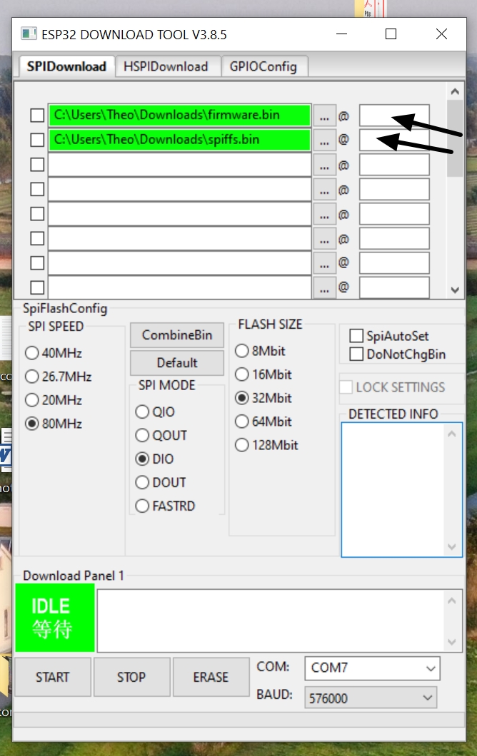

hmm, I can't seem to figure out at which hex addresses the bin files should be placed. :?:
Tried 0x10000 for firmware.bin and 0x4000 and 0x25000 for spiffs.bin, but that does not work.
I'm using the esp32 download tool from espressif.
Can I find the addresses somewhere?

Tried to upload the files to the ESP32-cam as described under “First time files upload”, but when I try to compile, Platformio keeps throwing an error. I’am new to Visual Studio Code/PlatformIO and can’t get rid of a error message about not finding “the package with ‘alanswx/ESPAsyncWiFiManager @ ˄0.22’.
That's why I want to upload both bin files (firmware.bin and spiffs.bin) to the ESP32 cam with the esp32 download tool from Espressif.
I can't seem to figure out at which hex addresses the bin files should be placed. Which addresses should I use for this?

It looks to me that the partitioning was from the 'default.csv'.
So from that file you could take the addresses. (no guarantee)
Normally you can find that file in:
C:\Users\<username>\AppData\Local\Arduino15\packages\esp32\hardware\esp32\<version>\tools\partitions
THBR
Posts: 43
Joined: Saturday 02 November 2019 21:05
Re: ESP32-CAM as doorbell with camera
Post by THBR »
Thanks for responding, hoping for a solution, I already purchased the hardware and a printed 3d case.
The contents of the default.csv:
# Name, Type, SubType, Offset, Size, Flags
nvs, data, nvs, 0x9000, 0x5000,
otadata, data, ota, 0xe000, 0x2000,
app0, app, ota_0, 0x10000, 0x140000,
app1, app, ota_1, 0x150000,0x140000,
spiffs, data, spiffs, 0x290000,0x160000,
coredump, data, coredump,0x3F0000,0x10000,
So I tried the offset:
firmware.bin 0x10000
spiffs.bin 0x290000
and also
firmware.bin 0x150000
spiffs.bin 0x290000
Both times writing went ok without errors and ended with "is stub and send flash finish"
But both uploads did not result that the camera came in into Wifi AP mode (no ESP Doorbell ssid).

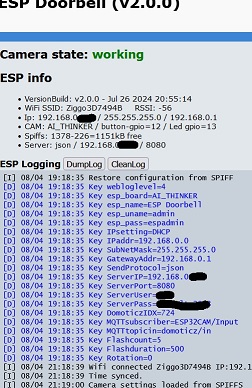

I don't know exactly how ("try and error"), but finally I got it working with the settings in the platform.ini:
- platform = [email protected]
- alanswx/ESPAsyncWiFiManager@^0.31.0
- bblanchon/[email protected]
Camera is working now, also added it with succes to Domoticz.

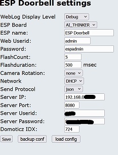

Another question (I am a noob...): when I push the button, a snapshot should be saved in /var/tmp ?
Nothing happens/no files saved in that dir
additonal information:
The push button apparently does not communicate with Domoticz at all. Switching a dummy/virtual switch (in this case with idx 724) also does not work.
