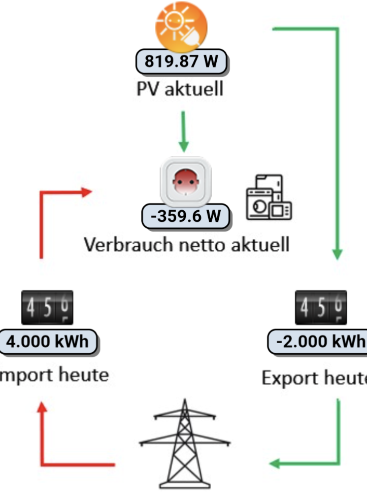

Post by hansvanlin »
Yes this is possible. I have it displayed, using iframe, in my nodered UI. Image

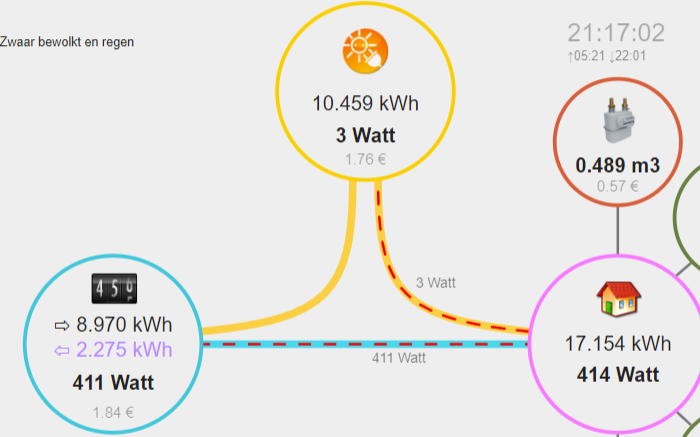

I think that there are still some calculation errors.
The converter uses some power when there is no sun.
So the Solar should read -3 Watt and the house should read 408 (411 - 3)
And the dotted line should go from meter to solar.

Post by gizmocuz »
Kedi wrote: Saturday 29 June 2024 21:25 I think that there are still some calculation errors
No there are not.
Grid = 411
PV = 3
Means House = 411 + 3 = 414 Watt
You get power from both Grid and PV
Grid = 0
PV = 0
= House = 0
Grid = 100
PV = 0
= House = 100
Grid = 0
PV = 100
= House = 100
Grid = 100
PV = 100
= House = 200

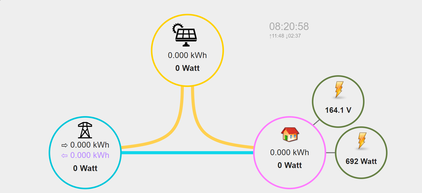

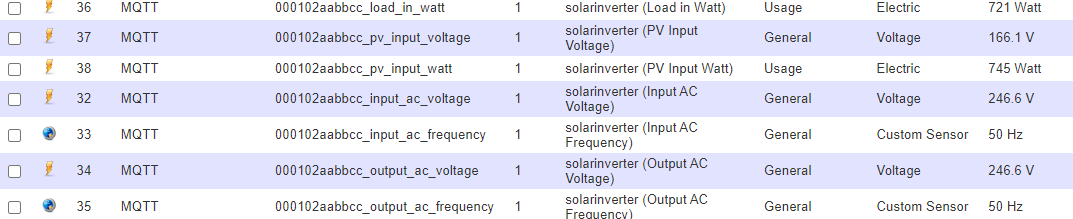

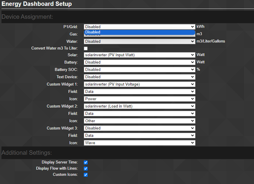

Thanks for the work done so far on the energy monitor. I'm using a Chinese inverter which I accessed using "SmartESS-proxy". The proxy returns parameters from the inverter by MQTTT, but the dashboard does not show the instantaneous power from the panels, and I cannot select the device indicating the "Grid" load i dont' need P1 energy monitor , how to change it (change device type to another). In the browser console, I get the message "Error with Power meter results. Check ID!" probably because the proxy does not send kWh data. How can I disable the kWh parameters for the energy monitor and is it possible to calculate the energy yield directly in Domoticz based on the provided values? Best regards.

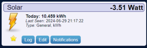

I placed 2 pictures. The 3 Watts in the Solar circle should be negative, see the widget.
The panels are consuming power instead of delivering power.
I am measuring power with a Shelly EM, and that device can measure in 2 directions positive and negative.
And yes a converter stays on the net and consumes power when there is no sun.
The house get some power and the converter get some power.
So the total of those 2 comes from the net.
Or do I make a mistake?
