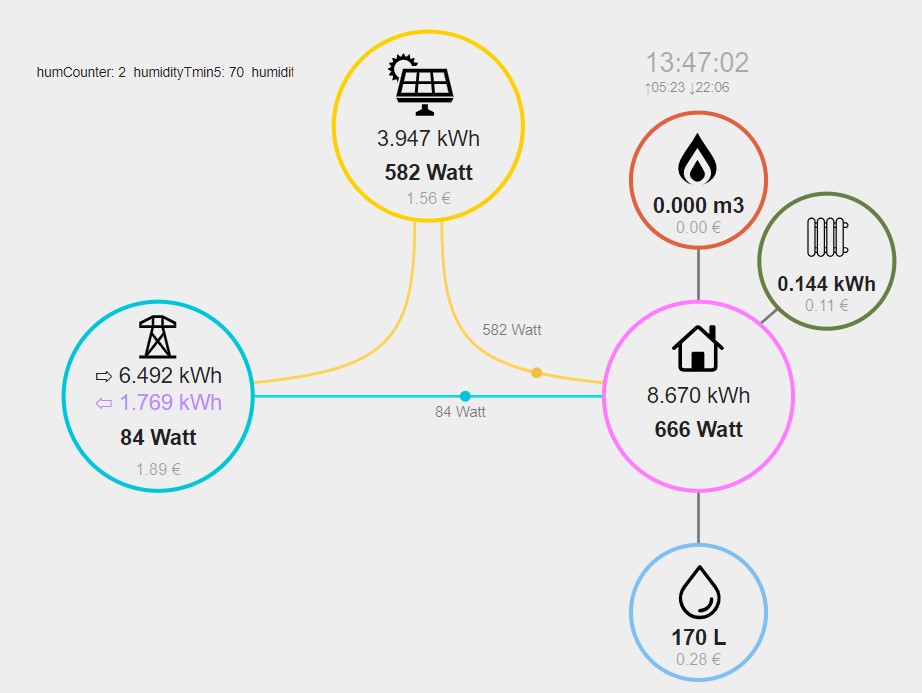

Re: Energy Dashboard (Build in)
Pls advise if this is normal behaviour on energy dashboard for my, somewhat large, text device.
7 lines in the device versus one (reduced length) line on the dashboard

How do you break your lines in the text device? \n

@gizmocus
commandArray['UpdateDevice'] ='1554|0|humCounter: '..tostring(humCounter)..'\r humidityTmin5: '..tostring(humidityTmin5)..'\r humidityTmin10: '..tostring(humidityTmin10) .. '\r Humidity current: ' .. tostring(current) .. '\r Humidity delta: ' .. tostring(xdelta) .. '\r targetFanOffHumidity: ' .. tostring(targetFanOffHumidity) .. '\r fanFollowsProgram: ' .. tostring(fanFollowsProgram)Raspberry pi 3b

@BartSr, it is either \n or \r\n not \r only. I suggest you use \n
