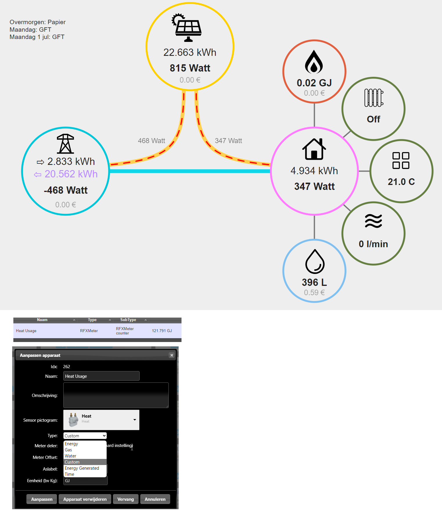

For the 'Gas' meter, it would be nice to also 'allow' RFX meter devices with a different Type (ie. Custom) to be selected in the settings. Esspecially for the people having District Heat (measured in GJ instead of M3 for Gas) this would be welcome..
I was able to select my RFX meter (Type = Custom) via a workaround and it seems to work properly (except for the costs which are shown as 0.00)
- first change the device type to Gas,
- then select the device in Energy Dashboard settings (it appears now)
- then switch back the device from Type = Gas to Type = Custom (GJ).

eddieb
- Posts: 391
- Joined: Wednesday 04 July 2018 7:48
Re: Energy Dashboard (Build in)
Did you change the type manually in the database ?
No, on the device itself. It's device type 'RFXMeter counter' (created via dummy hardware)
