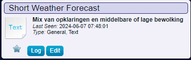

Works good now. 1 minor issue, the text does not completely fit. (Text from Buienradar.)

@kedi, that is a very long text line.. there is a mask so it does not overwrite the widgets.
(See the SVG inside the template)
You cannot replace icons! There are 5 icons you can pick from.
