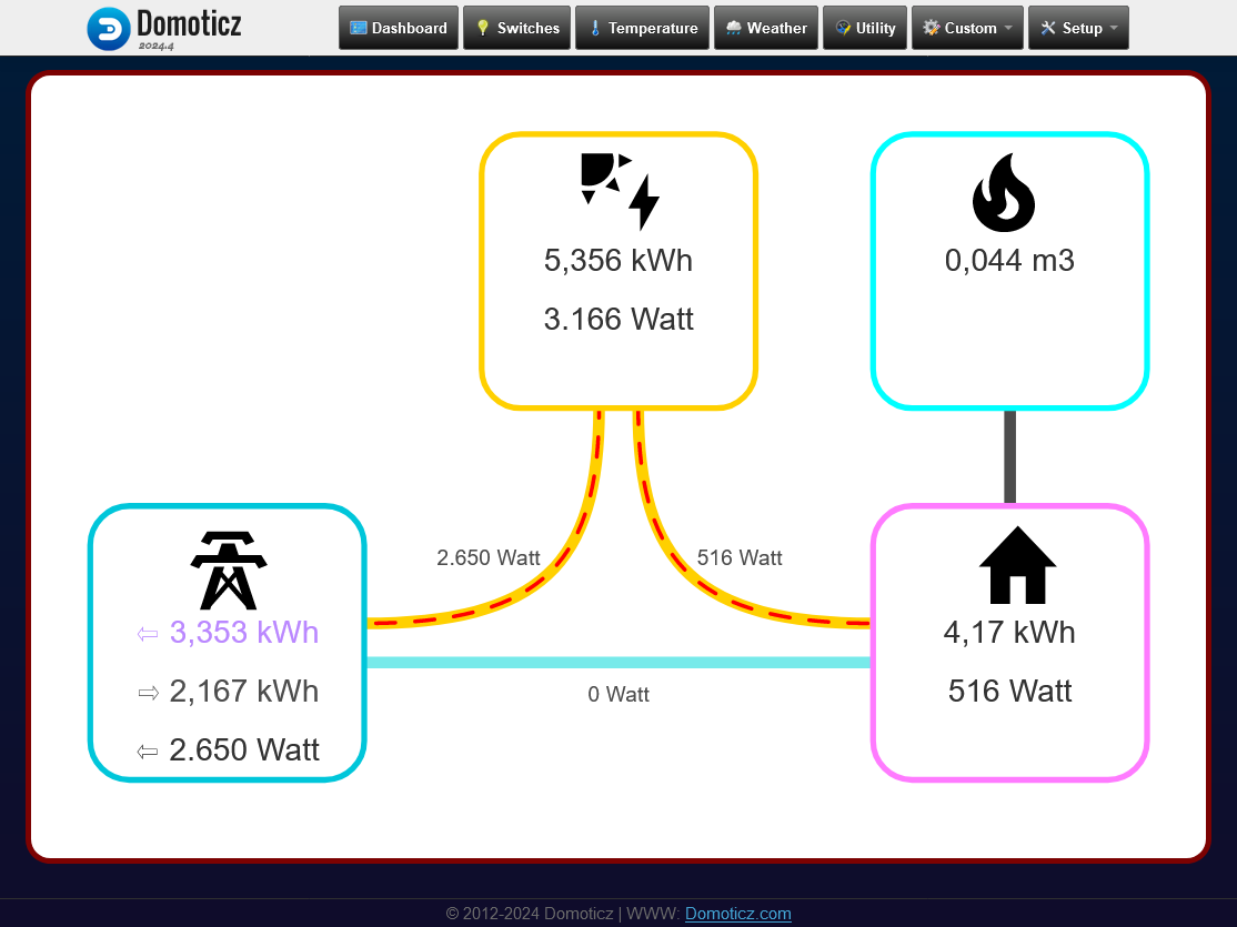

I have created an energy dashboard template for Domoticz:
Energy Dashboard.png (93.37 KiB) Viewed 6624 times
It also has some nice flow animations. :D
You can easily use it yourself if you have a similar setup as me.

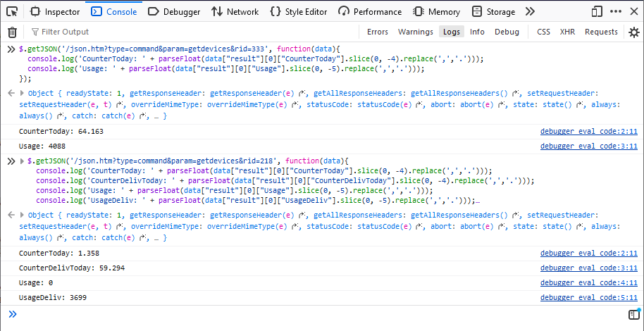

I had that result 1st too, after adjusting to
p1 =
Screenshot 2024-05-19 at 11.20.53.png (32.28 KiB) Viewed 6519 times
solar =
Screenshot 2024-05-19 at 11.21.34.png (21.79 KiB) Viewed 6519 times
it works

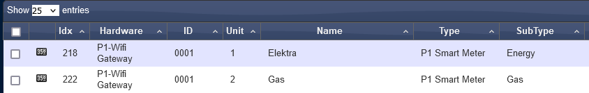

This is how my meters look on the devices page:

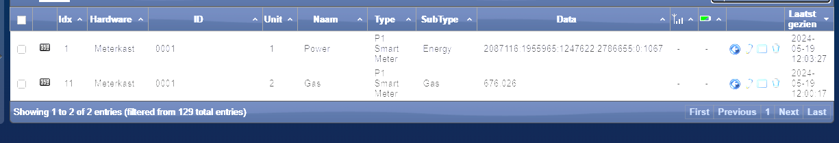

This are my meter look on the devices page:
Schermafbeelding 2024-05-19 120339.png (36.08 KiB) Viewed 6514 times
I don't understand what is wrong with the indexes?

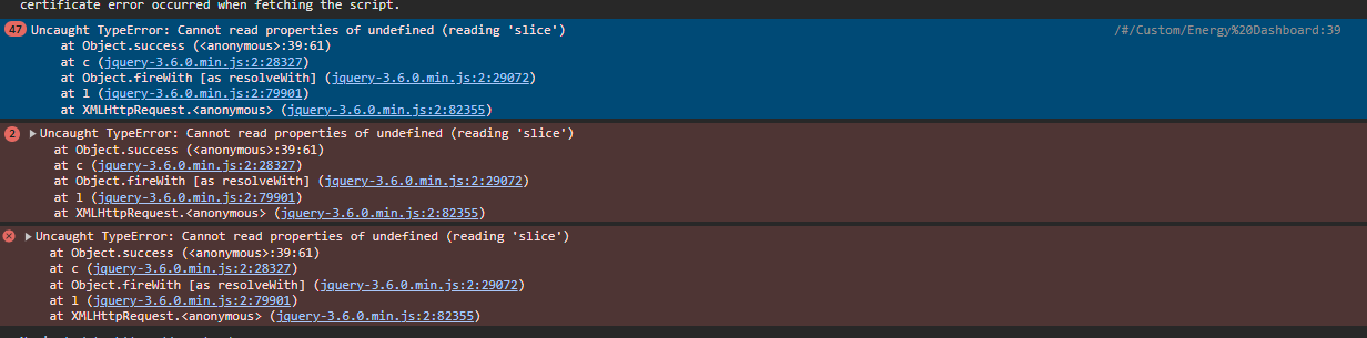

Looks good indeed, I also checked your the data from your P1 meter. All the required fields are there.
Can you check in your browsers developer tab if there are any errors when you load the page?
In FireFox you can press F12 to get to this. Select console and then reload the page.

This script doesn't work for me. it doesn't show any data.
My json from Solar Power looks like this:
ActTime	1716114306
AstrTwilightEnd	"23:16"
AstrTwilightStart	"01:37"
CivTwilightEnd	"20:57"
CivTwilightStart	"03:55"
DayLength	"15:40"
NautTwilightEnd	"21:53"
NautTwilightStart	"03:00"
ServerTime	"2024-05-19 12:25:06"
SunAtSouth	"12:26"

MeneerKlaas wrote: Sunday 19 May 2024 12:12 Looks good indeed, I also checked your the data from your P1 meter. All the required fields are there.
I think it is something to do with .slice or?
Schermafbeelding 2024-05-19 173626.png (55.79 KiB) Viewed 6452 times
EDIT: If I set the solar device inactive it works. But I have no seperate device for it, it's part of P1. How can i make it right?

Some browser debugging tips.
When on your domoticz page. Go to the console in your browser.
Validate Solar (XXX = your SolarID):
$.getJSON('/json.htm?type=command&param=getdevices&rid=XXX', function(data){
  console.log('CounterToday: ' + parseFloat(data["result"][0]["CounterToday"].slice(0, -4).replace(',','.')));
  console.log('Usage: ' + parseFloat(data["result"][0]["Usage"].slice(0, -5).replace(',','.')));
Validate Power P1 meter (XXX = your PowerMeterID):
$.getJSON('/json.htm?type=command&param=getdevices&rid=218', function(data){
  console.log('CounterDelivToday: ' + parseFloat(data["result"][0]["CounterDelivToday"].slice(0, -4).replace(',','.')));
  console.log('UsageDeliv: ' + parseFloat(data["result"][0]["UsageDeliv"].slice(0, -5).replace(',','.')));
For me it looks like this when I run the two commands:
Debug Meters.png (54.15 KiB) Viewed 6441 times
