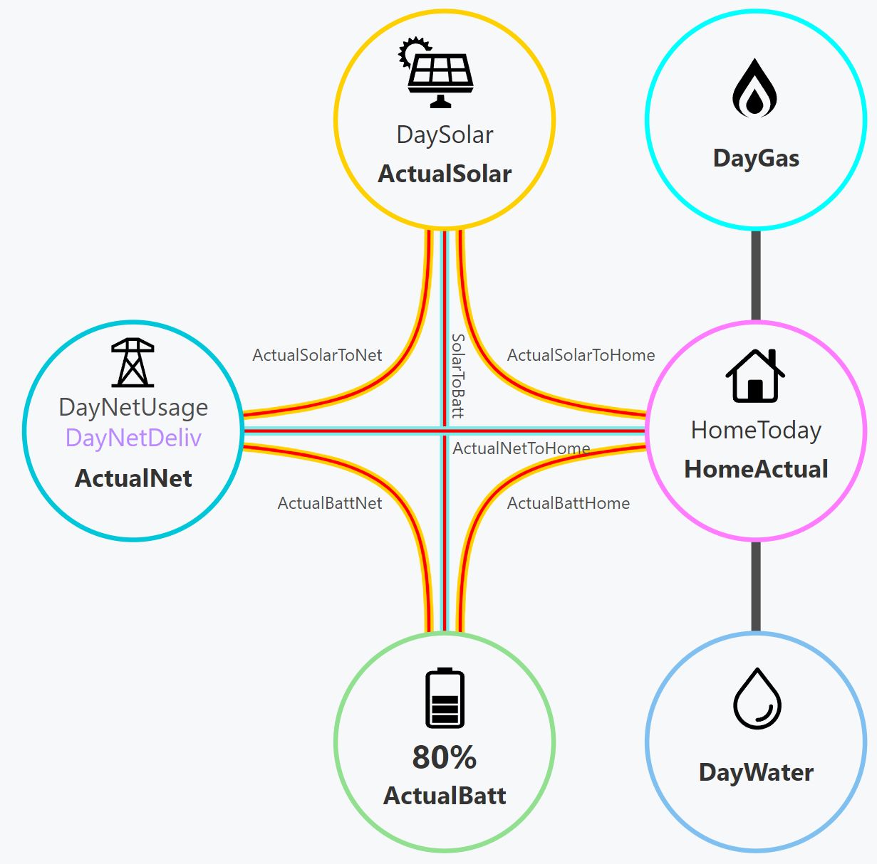

Re: Energy Dashboard - Template
No worries... But... please find here a version that you can also use without a battery, please see inside the file how to use it
I also added the option for a Water meter
Edit: New dashboard where items are placed aligned, and changed the icons

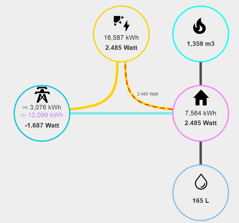

Hi @gizmocuz
i tested your latest version. looks nice. but I have also a couple of things.
I tested with Firefox and Chrome browser
1.
If I start the "Custom" page in Firefox it does not update the data.
It starts updating after I loaded the first version (1.1) of MeneerKlaas.
Returning to your latest version updates the values, but the calculation is not correct.
To show the correct picture with updating values and animation of have to refresh the page by pressing F5.
I do not know, if this is caused by the updated cache functionality.
See:
The values in the "Solar circle" and the "P1 circle" are correct.
Therefore I don't see any animation from the Solar panels to the grid.
Sometimes I notice negative values in the "Home circle". This is not expected.
2.
As I receive the water value in Liters and not in m3, I changed the script to display L instead of m3.
See the screenshot
3. If I change the viewBox:
In this case the screen does not show the lower circles in landscape mode. It is okay in portrait.
I do not see, why the calculations are wrong, as they are correct in version 1.1
1.
See:
2.
See the screenshot
I did that, because I do not have a Battery yet. (Perhaps we can use the battery of my car)Notes:
When not using a battery and/or water meter, set the viewBox of the SVG object below to viewBox="0 0 60 40" to remove the empty space below

Lastest from @gismocuz Animation and figures are not completely correct.
- FireWizard
- Posts: 1975
- Location: Voorthuizen (NL)
Hi @Kedi,
I see you have the same issue with the calculation of the power at home, as I have.
Now, when the solar panels stop producing, it is correct.
And how is your screen?
Also, you used a lot of water
You can change that to L, like I did, or you can divide it by 1000.

My screen is also fine when the solar panels stop producing.FireWizard wrote: Sunday 02 June 2024 22:05 Hi @Kedi,
On my widget it is L(iters). I did not notice that that was not transfered. I change that.Also, you used a lot of water.

I see 0 kWh at my house now. Is that correct?
I think fDayHomeUsage is never calculated, is that correct?
Edit (again):
Got it, I think. Added
// Home usage: Calculated
fDayHomeUsage = fDayNetUsage + fDaySolar - fDayNetDeliv;
fActualHomeUsage = fActualSolar;
if (fActualNet > 0) {
fActualHomeUsage += fActualNet;

For my understanding. What are idBattSetpoint and idBattSoc values stand for?
Greetings McMelloW
- gizmocuz
- Posts: 3026
- Location: Top of the world
@McMelloW , If you have a battery at home, you need to charge/discharge it. You do this via a Setpoint device, like a thermostat setpoint.
You set it to 300, and it will charge with 300 Watt. Setting it to -300 it will discharge with 300 Watt
SOC (State of Charge) is a device that tells you how full a battery is, 0=empty, 100=100% full
