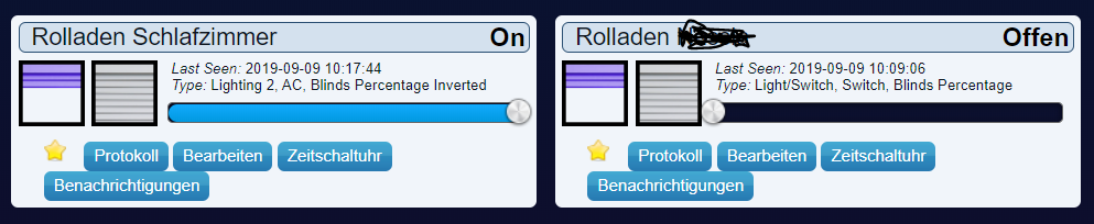

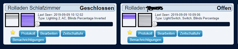

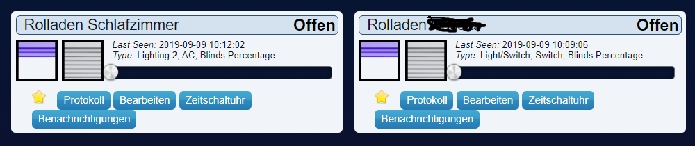

So, i double and triple checked everything.
Shut down in Real and in the App, Domoticz set to Inverted, Percentage Bar Wrong, Icons correct
Shut down in Real and in the App, Domoticz set to Normal, Percentage Bar correct, Icons and Text Wrong
Shut down in Real and in the App, Domoticz set to back to inverted, Percentage Bar wrong Icons correct Text ?

in Domoticz the Percentage Bar say, no matter if I switch to Normal or Inverted - 20%
and i real it is 60% closed...
So the real Thing seems to Work more or less, but the Percentage Bar in Domoticz making Problems and did not fit the Icons and the Text

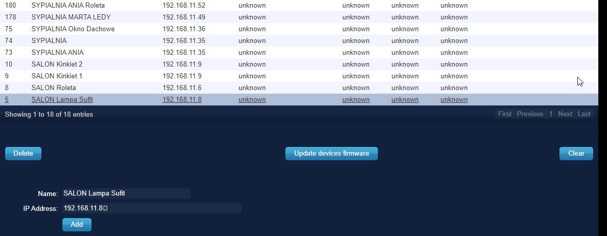

Strange symptom after V2021.1 build 13196 deploy. All Blebox hardware in line IP Adreess at the end of line have special character (attached screen).
Not possible to delete them and if I tried add device once again this special character is added to IP address at the end automatically.
Blebox hardware config
2021-04-19 10_28_55.jpg (61.04 KiB) Viewed 4514 times
Still blebox devices doesn't work. Log errors:
2021-04-19 09:27:30.857 Error: BLEBOXY: Invalid json received!
2021-04-19 09:27:39.300 Error: BLEBOXY: unknown device (192.168.11.6)
