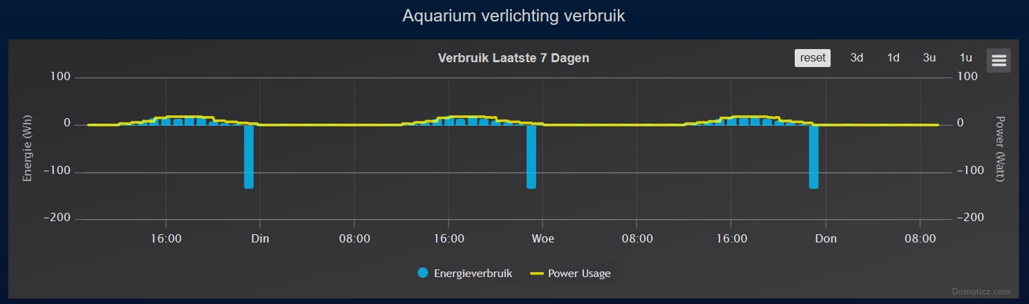

I have the following script running with succes for calculate total usage for few seprated led strips. I use the script for different uses, but there is one problem I already play with a long time but didn't find any solution yet.
My scripting is not the best, but what i archieved already in domoticz i'm really proud on!
The script is:
--	on = {
--	    timer = { 'at 00:00' }
		devices = {
			'$Aquarium verlichting Rood',
	execute = function(dz, item)
	    local RoodToday = dz.devices(451).WhToday
	    local GroenToday = dz.devices(454).WhToday
	    local BlauwToday = dz.devices(457).WhToday
	    local WitToday = dz.devices(460).WhToday
		local TotaalToday = RoodToday + GroenToday + BlauwToday + WitToday
		local RoodPower = dz.devices(451).actualWatt
	    local GroenPower = dz.devices(454).actualWatt
	    local BlauwPower = dz.devices(457).actualWatt
	    local WitPower = dz.devices(460).actualWatt
		local Power = RoodPower + GroenPower + BlauwPower + WitPower
	    if dz.time.matchesRule('at 00:05-23:59') then
            dz.devices(1174).updateElectricity(Power,TotaalToday)
--        if dz.time.matchesRule('at 00:00') then
--          dz.devices(1174).updateElectricity(0,0)
--        end
You see, i already tried sending a 0 at midnight what doesn't work. Also different times around midnight, found that as solution but doesn't work.
In the picture below you see the total usage at midnight getting negative.

Energy read is "from device" and not on "computed". It works on Computed, but the difference with the real calculation is for my purpose to big.
For now, i delete the value and the day value get's correct. But doing this every day is a little bit to mucht work so I hope someone can help me with the script to make it workable!

You should add the current TotalWh of your total device. The Energy should not go zero every day but a runing increasing value (like your home energy meter)
So add in the begin of your script
local TotaalWh = dz.devices(1174).TotalWh
Then modify your update line to
dz.devices(1174).updateElectricity(Power,TotaalToday+TotaalWh)

rolfie23
Joined: Saturday 11 January 2020 10:37
Domoticz version: 2024.7
Re: DZvents power get negative at 00:00
Post by rolfie23 »
Thanks waltervl found the solution thanks to you. Quite simple, and worked perfectly last night.
Maybe you have some adjustments on it, please let me know:

Posts: 6689
Domoticz version: 2025.1
Looks perfect! I see a made a mistake in my TotaalWh definition but your solution is perfectly fine.
