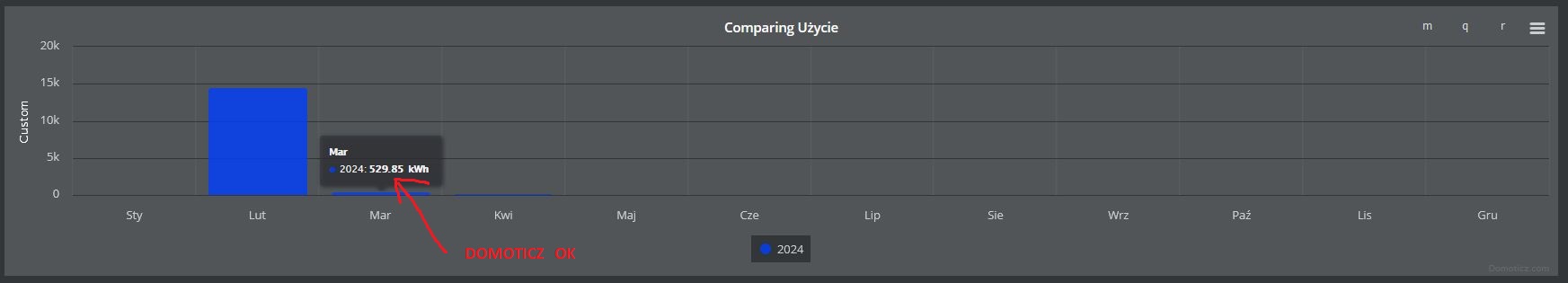

I want:
1. Daily consumption chart from 00:00 to 23:59
2. Month graph - showed consumption every day of the month
3. The year graph showed the consumption in each month to see how much energy was used in each month
After logging out, I see jpg
I want:

One month - very good indications:
Year - wrong readings - wrong energy readings:

Lokonli
- Posts: 2296
Re: Bar chart in dashticz - block definition
Hint:
March has 31 days.
31 * 17.09 = 529.79
https://dashticz.readthedocs.io/en/beta ... ml#groupby
March has 31 days.
31 * 17.09 = 529.79

Unfortunately, I still don't understand how to set the chart for a year to show everything in 1 month.

This is how Domoticz shows the value - month
The Dahstick shows the average and I want it to show all the energy in a month.
I have the energy consumed every day in a chart - a month, so there is no need for energy in the average value.
Which setting exactly is responsible for this?

Lokonli
- Posts: 2296
Try adding:
aggregate: 'sum',

This is how it works thanks to this change. It shows bars showing the total monthly energy consumption.
