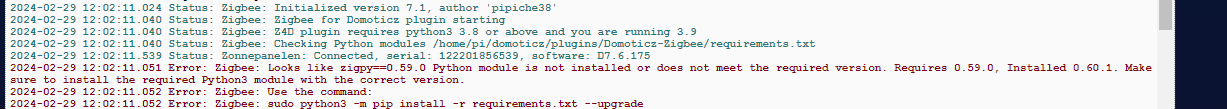

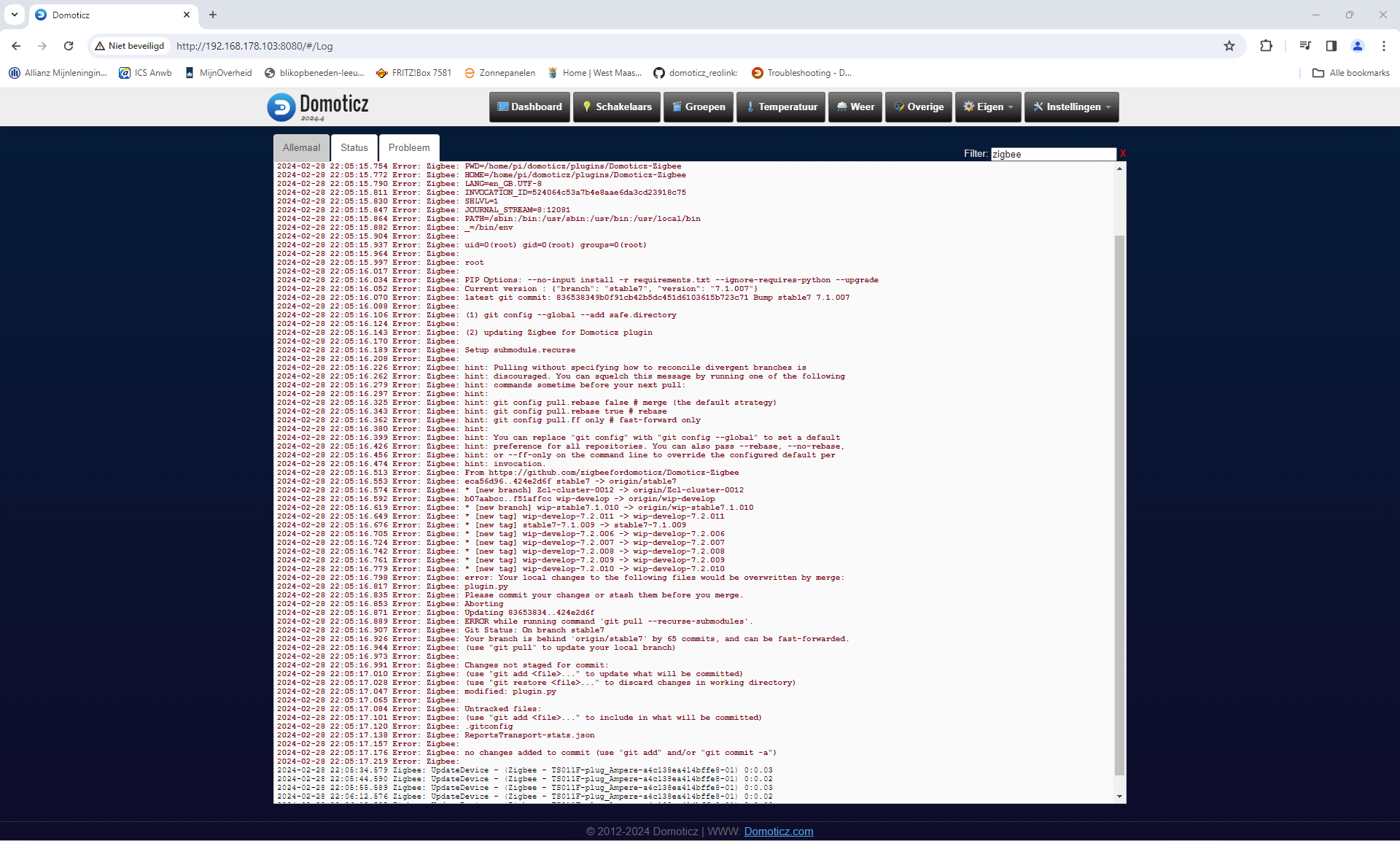

If i try to update the Zigbee4Domoticz plugin, it fails. The plugin itself is working ok. There seems to be a owner issue somewere, i think. I have already removed and re-installed the plugin severaltimes, but everytime if there is a update the plugin fails to update. I can do a fetch and then rebase autostash, the plugin is updating. What can be the reason for the failing?

Indeed it looks like the update cannot go through, because found some changes.
can you try the following
Open a terminal window, and go to the plugin folder
If no error, then simply to the update via the WebUI
git can you try the following
git reset --hard
git pull

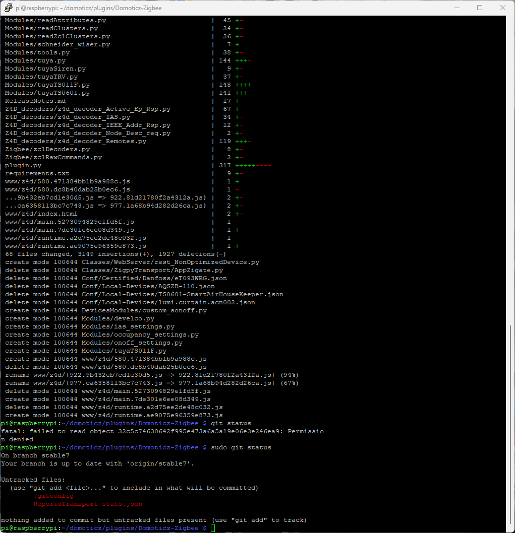

Thanks,
First, i have to 'sudo' the 3 commands, is that normal?
After the hard reset, pull and status and Domoticz service restart the plugin didn't start. I had to upgrade the requirements.txt as adviced. After that and domoticz restart the plugin is starting and updated.

@Rik60, the sudo command is normal.
Can you please run sudo python3 -m pip install -r requirements.txt --upgrade and paste here the results of the command ?
