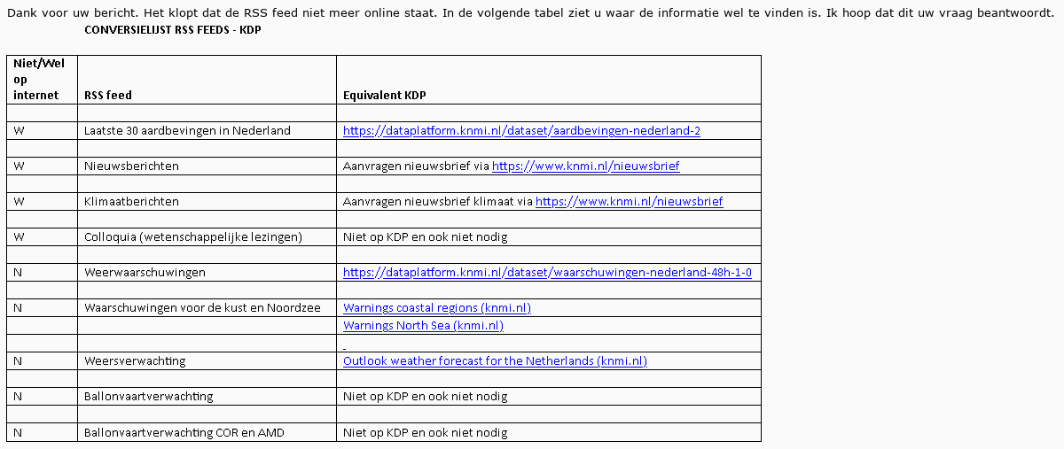

Hello all,
I received an update from KNMI (in Dutch), as follows.
As you can see, this does not help us very much.
The URL for "Weerwaarschuwingen" is the one, I already looked at. That one is very complex.
But I discovered, they have now a MQTT server available. I will investigate that one in the next days and keep you updated.
