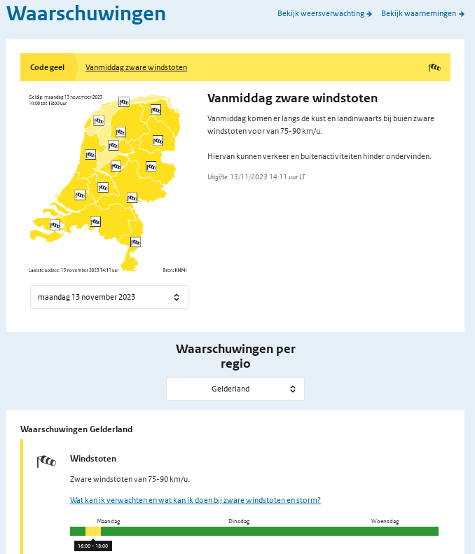

The Dutch website with the map can be visited at https://www.knmi.nl/nederland-nu/weer/w ... en/utrecht.
Insert your province, as Utrecht is the default,

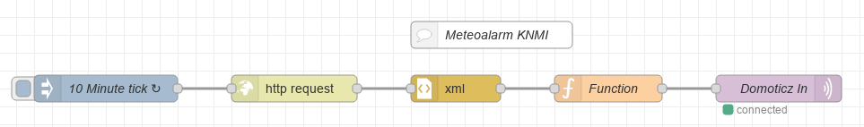

The flow is presented in the picture below:
Some explanation of the working.
At the far left you will see an "Inject"node, which provides a 10 minute "tick". So the data to Domoticz is updated every 10 minutes.
It requests the data from the KNMI webfeed at https://cdn.knmi.nl/knmi/xml/rss/rss_KN ... wingen.xml
As this is XML data, it is sent through a XML node in order to convert it from a XML string to its JavaScript object representation.
This is used as input in a "Function" node. The Function takes care of the conversion to the Domoticz format.
The contents is as follows:

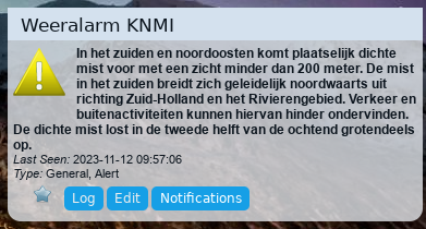

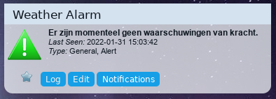

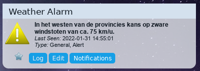

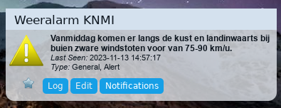

If everything is finished you will see:
And hopefully very soon:

Post by FireWizard »
As I mentioned already in my previous post I will share a new Node-RED flow, that uses web scraping from
https://www.knmi.nl/nederland-nu/weer/w ... gelderland or any other area (12 provinces and 3 coastal areas), if you use the correct name in the URL
The page shows the following:
I use the text in the upper left corner (in this case "Code geel") and as alarm text I use the first sentence under the header (in this case "Vanmiddag zware windstoten).
In this case the widget looks as follows:
Other texts are possible, but be aware, that these are not to long , as it will not look nice.
Screenshot_weather_alarm_long text.png (100.67 KiB) Viewed 6751 times
This is the reason I use only the first sentence.
As said earlier this information is visible as soon as for one of the areas KNMI issues a weather alarm so it may not apply to your region.
Please find the Node-RED flow below.
Do not forget to insert your own IDX number and the configuration of the MQTT server.
