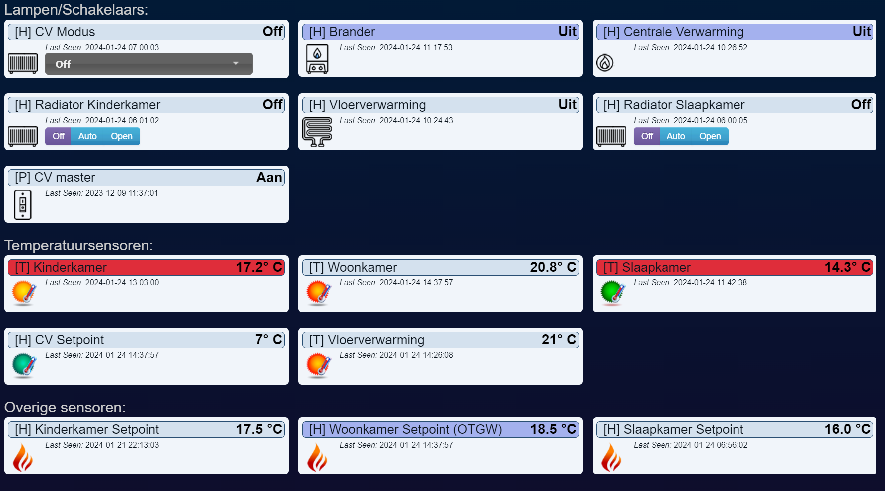

For the ones interested here is my script to manage the heating in my house. Control the central heater to allow specific room heating.
In short
- one script to control the floorheating pump, if the temp sensor attached on the inlet tube reaches the desired temp, the pump wil get activated.
- another script to control heating in the different rooms (2) with different modes (off, passive, active seperate or active both rooms)
Specifications
- The floorheating will be disbaled (pump will not be activated) if the roomtemperature is below/equal to setpoint and another room is activated
- The room activation temperature can be activated bij the knob in the room itself but also with a virtual switch
- With this code activating the central heating without any valves open should be avoided. If the CH is active the pump floorheating or at least one valve is fully opened.
Devices / Hardware
- OTGW plugin
- Remeha Home plugin (optional)
- Virtual Sensors
- Fibaro Heat
- Eurotronic spirit
- Relais switch with temp sensor (Qubino Flush)
stoomdiagram verwarming.pdf
(74.15 KiB) Downloaded 231 times
(OUTDATED)
The code is working, but still in development for further improvement
