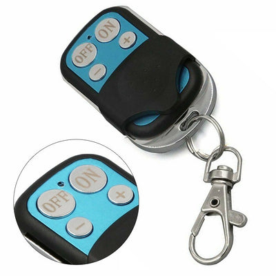

I have a "standkachel" to use this there is e 433mhz remote, i can add them to domoticz
i can also use the + and - button to control the heater,
but.... to power on the heater, i must press the "on" button for 3 seconds, same to power off the heater.
How can i manage to send the power on/pff signal for 3 seconds with rfxcom and domoticz?
