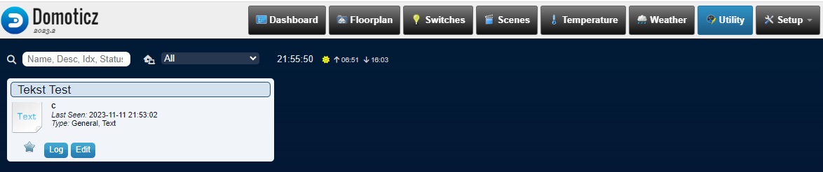

But how do I put this const char* c into the TEXT part of the json syntax?
url = "/json.htm?type=command&param=udevice&idx=IDX&nvalue=0&svalue=TEXT";
If I do the next line:
url = "/json.htm?type=command&param=udevice&idx=83&nvalue=0&svalue=c";
I get:
