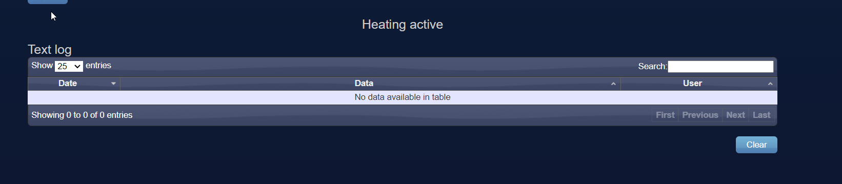

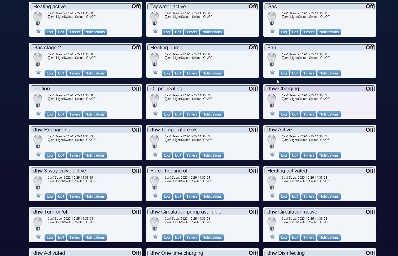

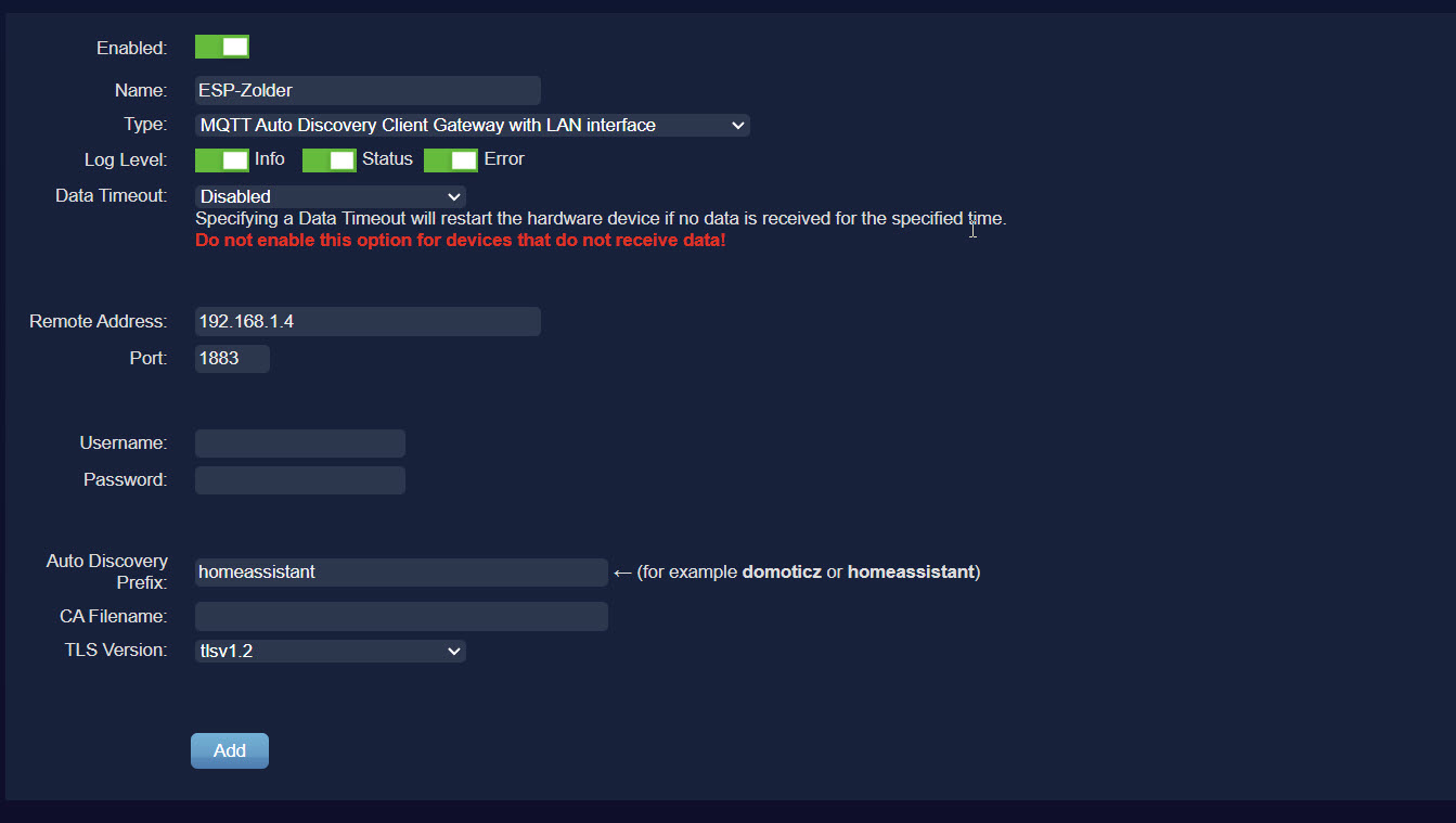

Last week the sensors configured in my Domoticz system stopped working. After deleting and re-adding the MQTT autodiscovery plugin, the sensors are registered as switches, wich do not respond to any command en show no logging. I am using an ESP-32 wich is connected to my boiler, and sends MQTT topics to my mosquitto MQTT server. I add the MQTT AD plugin with the settings of the mosquitto broker.
Reinstalled my raspberry PI with the latest distro Bookworm. Whas running Buster. Reinstalled Domoticz and the latest version of Mosquitto. Edited the security settings to be able to connect to my broker.

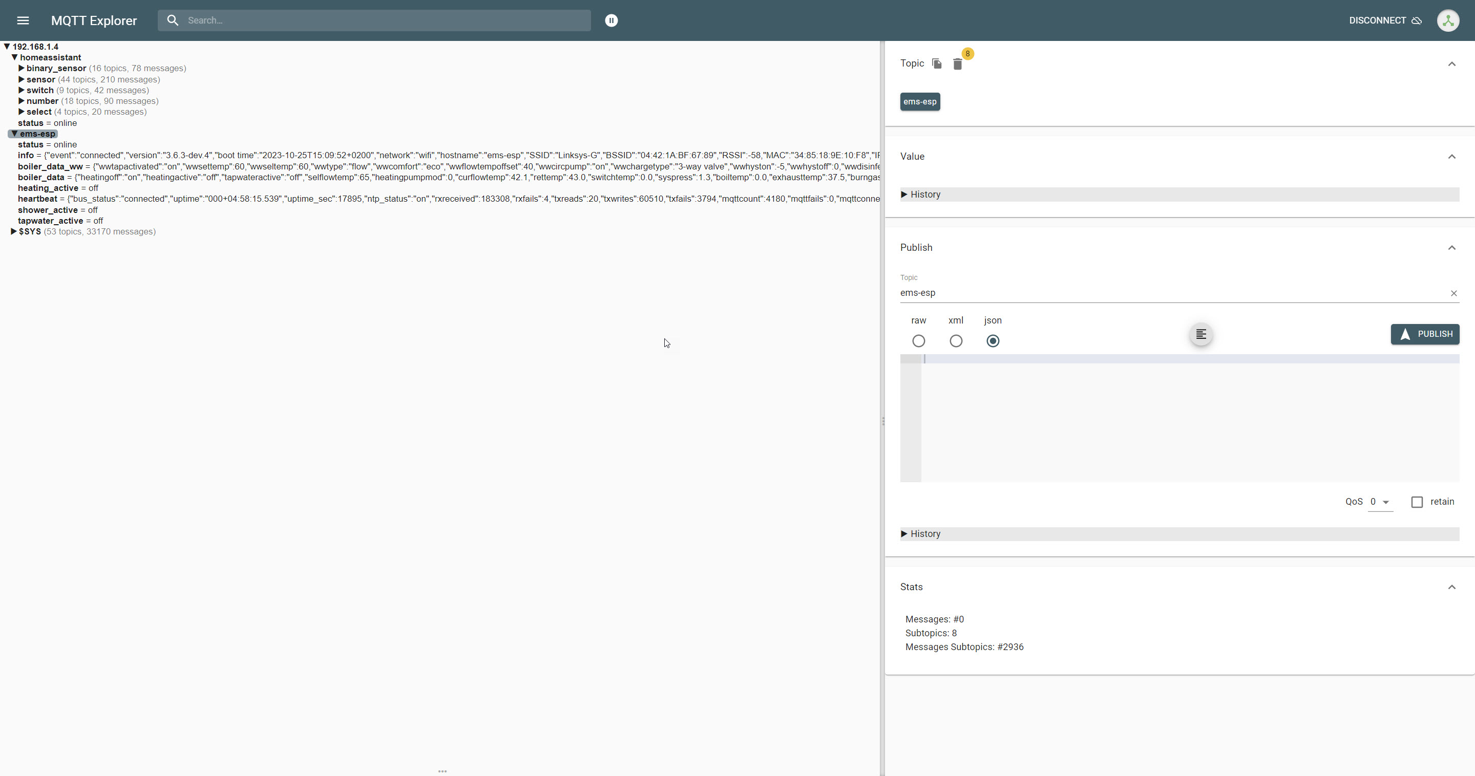

Do you see MQTT AD messages with MQTT explorer? https://www.domoticz.com/wiki/MQTT#Debugging_MQTT
Is Domoticz seeing the MQTT broker (Mosquitto)?
What does the domoticz log say (menu setup - Log) if you restart the MQTT AD hardware in Domoticz? Select the MQTT AD hardware in menu setup - hardware and click on update to restart.

Yes, I believe so. See screenshot of my MQTT explorer.
Log from domoticz is also attached.

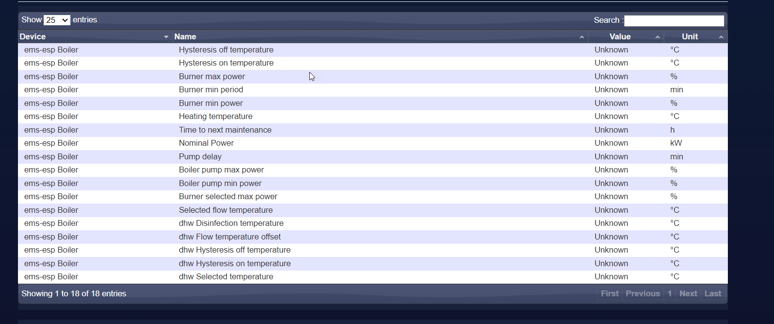

Looks like you are missing sensor data in the ems-esp topics. So Ems is not sending the data as configured in the homeassistant config topics.

Ok, thanks for checking. Just to be sure; it looks like the ems-esp is not doing what it is supposed to be doing?

Yes it looks like the ems-esp is not doing. See page for all the topics it should send https://emsesp.github.io/docs/MQTT/#published-data
