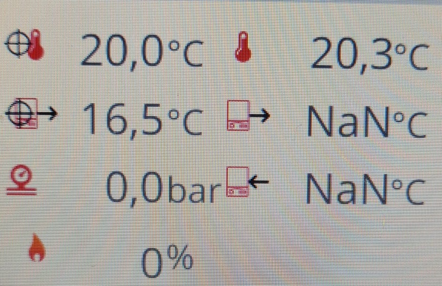

I have a Toon 2, rooted. It's running a few weeks, no problems.
The heating is on since a few days, since then i have errors.
Domoticz 2023.2
Plugin 1.4.22
Any idea?

Looks like you are not getting the info from : boilerState
Can you check on your Toon if the info is available
marktn
Posts: 232
Re: Rooted Toon plugin
Post by marktn »
You mean this? That seems not to be working, i think...
I need this, to get it working?
madpatrick
Posts: 758
Domoticz version: 2025.2
Post by madpatrick »
No.
You can check if it is updating by
http://YOUR_TOON_IP/happ_thermstat?action=getThermostatInfo
burnerInfo is 0 when not heating and 1 when heating.
If you change the temperatuur to higher then roomtemperature and your seeing the little flame in the display is must show "1"
marktn
Posts: 232
Post by marktn »
Looks good.
When settings the temp higher, no error.
burner 1:
{"result":"ok", "currentTemp":"1992", "currentSetpoint":"2000", "currentInternalBoilerSetpoint":"30", "programState":"1", "activeState":"0", "nextProgram":"1", "nextState":"2", "nextTime":"1697659200","nextSetpoint":"1500","randomConfigId":"1804289383","errorFound":"255","connection":"0","burnerInfo":"1","otCommError":"0","currentModulationLevel":"0"}
burner 0:
{"result":"ok", "currentTemp":"1992", "currentSetpoint":"1500", "currentInternalBoilerSetpoint":"6", "programState":"2", "activeState":"2", "nextProgram":"1", "nextState":"1", "nextTime":"1697691600","nextSetpoint":"1850","randomConfigId":"1804289383","errorFound":"255","connection":"0","burnerInfo":"0","otCommError":"0","currentModulationLevel":"0"}
Only this error, Error: Toon Rooted: CConnection_connect, connect request from 'Toon Rooted' ignored. Transport is connected.

marktn
Posts: 232
Post by marktn »
update, Refresh interval was 5 minutes, set to 1 minutes now. Looks better. A few minutes without errors.
marktn
Posts: 232
Post by marktn »
The Error only appears when the programma is changing on the thermostat.
For the rest no error since yesterday.

marktn
Posts: 232
Post by marktn »
After setting the refresh to 1 minute during the day no error.
Only when switching from sleep to home the Error is there. Anything to do against that?
madpatrick
Posts: 758
marktn wrote: Saturday 21 October 2023 11:37 After setting the refresh to 1 minute during the day no error.
I can not reproduce your problem.
Seems like your Toon is not responding correctly. The error your are Domoticz is not getting a connection to the Toon
Have you tried to reboot your Toon?
