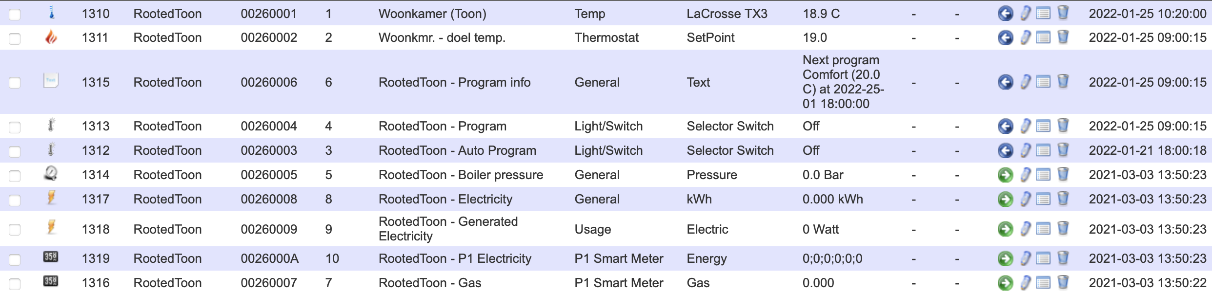

Goodmorning,
I have a Rooted Toon2 working fine, and connected with Domoticz, with these settings. I do see the devices created by the plugin. I deactivated the ones which do not function because the boiler does not give the info, and I use a P1 meter, so not interested in double info
about Gas and Electricity.
In the log I constantly see these error.
I does not help to activate devices which I deactivated, so that's not the solution.
Please help, thanks

ronalddehaan
- Posts: 11
- Joined: Monday 09 October 2017 10:20
- Domoticz version: 2021.1
Re: Rooted Toon plugin
Solved my problem cosmetically by turning off the error logging. Everything seemed to be working fine, so for the time being, this will do for meronalddehaan wrote: Tuesday 25 January 2022 9:31 Hey guys,

Guys,
I've cloned the plugin and made a small update
- Change : Devices are created automatically
- Change : New device : Boiler status
- Change : small name changes
I hope to make a update on the Toon Scenes based on the temperature change
If somebody has pyhton scripting experience i need all the help there is
Location of the plugin : https://github.com/MadPatrick/domoticz_toon
The best is to start with a clean install

Is there a option to select witch sensor we want to use or not.
I use a Toon V1 with thermostat on/off mode.
And i have an external P1 port reading.
In domoticz there are several devices created by the plugin i do not use Humidity and system pressure.
when i delete them the script creates them again.
by the way it is working fine and nice work

Not at the momentPeJeWe wrote: Thursday 12 January 2023 14:58 Is there a option to select witch sensor we want to use or not.
by the way it is working fine and nice work![]()
It is quit difficult to make too many option in a plugin.
You can always disable the device is the section Devices in Domoticz.
Also there difference between v1 en v2. And also per version there differences
PeJeWe
- Posts: 70
- Joined: Monday 28 November 2016 20:52
- Domoticz version: Latest
When I disable them I get errors in the log section.
Can't auto create device because " auto add hardware" is off
Can I disable it in the python script?
Update:
I have managed to adapt the python script to disable the creating of the unnecessary sensors and disable the error giving in domoticz
Update:
