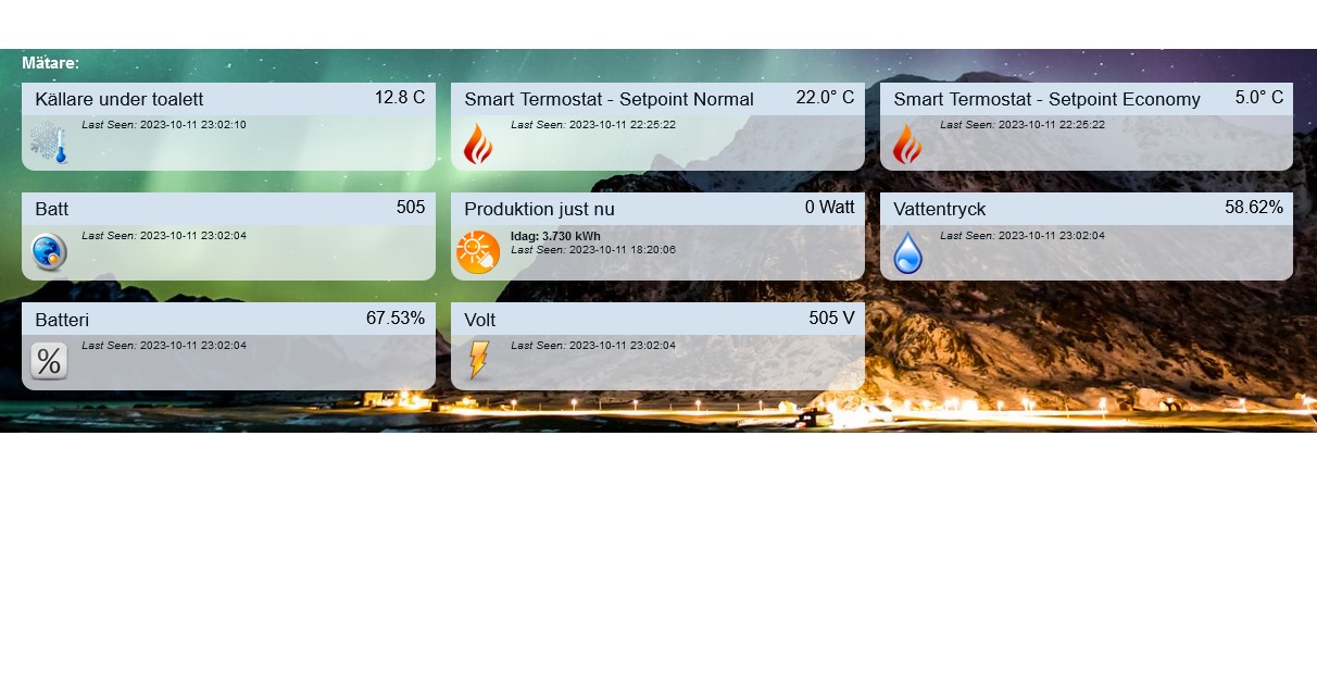

ok then it is not what i want..
my final goal is this..
my device Batt has a value (in real world it is a 24v battery charging from 23-27 volts)
and this gives a value from lets say 300 to 520 something from (hardware Denkovi to domotics)
i want to create a dummy volt sensor that translates values to volt..
like Batt value 300-315 is 23Volt, Batt 315-320 is 23.5 volt and so on..
Batt is a custom sensor
Volt is a dummy voltage sensor
- domoticz.jpg (160.96 KiB) Viewed 1392 times
