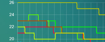

I have been using several TS0601-eTRV7 thermostat valves for some time. I have also got some Sonoff temp/hum sensors connected and it occured to me that the TRV's are only giving integer temperature values , while the Sonoff sensors are reporting with one decimal.
The TRV graphs are kind blocky because of this. Can this somehow be changed in the parameters?

I’ll have a look, but I suspect that the device is sending data like that

It seems originally they could use steps of 0,5 degrees C, judging from the TUYA export:
"code": "temp_current",
"name": "当前温度",
"type": "Integer",
"values": "{\"unit\":\"℃\",\"min\":-100,\"max\":500,\"scale\":1,\"step\":5}"
Assuming the -100 means minus 10 degrees C and 500 means 50 degrees C.
hope you can help here! thanks in advance.
