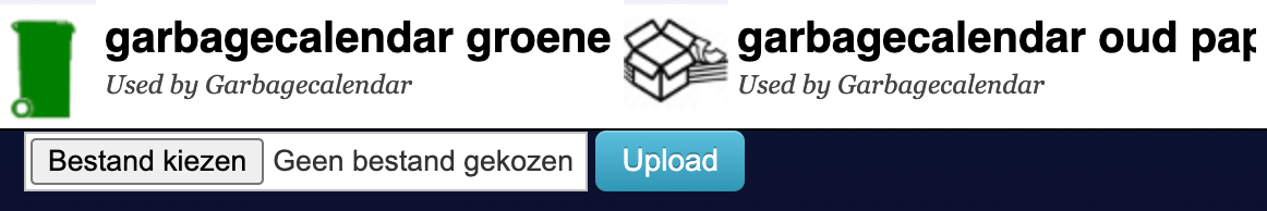

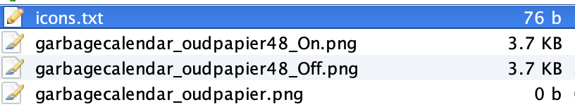

Send me your iconset (zip file) you are trying to upload and I will have a look when you want.
You can also add them to the garbagecalendar\icons subdirectory under an name this isn't uploaded to domoticz yet, and use that name in the config. That way the scripts will do the upload for you when it isn't available yet.

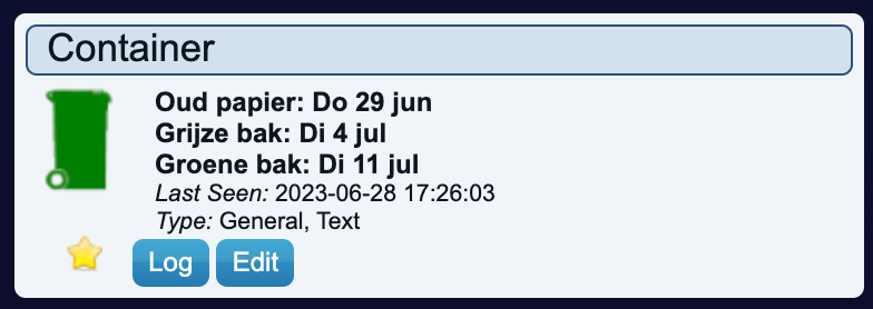

Thanks for the push (via PM) in the right direction, everything is working fine now.
Great script, thanks for your hard work!

and the icon hasn't changed, it's still the "groene bak" from last Tuesday.
In the config file I have
["plastic, blik & drinkpakken"] ={hour=19,min=02,daysbefore=0,reminder=0,text="Plastic bak", icon="garbagecalendar_orange"},
["gft & etensresten"] ={hour=19,min=02,daysbefore=0,reminder=0,text="Groene bak", icon="garbagecalendar_green"},
["papier en karton"] ={hour=19,min=02,daysbefore=0,reminder=0,text="Oud papier", icon="garbagecalendar_oud_papier"},
["restafval"] ={hour=19,min=02,daysbefore=0,reminder=0,text="Grijze bak", icon="garbagecalendar_grey"},
Also I see this:
Scherm­afbeelding 2023-06-28 om 17.26.48.png (49.59 KiB) Viewed 5205 times
Edit:
I do see the iconset uploaded when I check the custom icons. Why doesn't it use the iconset then?
jvdz
Posts: 2441
Domoticz version: 4.107
Re: GarbageCalendar (new version) lua scripts
Post by jvdz »
The zip file needs to be correct and naming consequent throughout!
This means that not only the filename of the icon is important but also the name in the file icons.txt needs to be correct!
Just do a API call manually yourself: /json.htm?type=command&param=uploadcustomicon which will list all available icons and "garbagecalendar_oud_papier" in not one of them at them moment!

The text file contains this:
garbagecalendar_oudpapier;garbagecalendar oud papier;Used by Garbagecalendar
Scherm­afbeelding 2023-06-28 om 17.56.27.png (28.97 KiB) Viewed 5192 times

jvdz
Posts: 2441
Post by jvdz »
Well my JSON link as well which should be: /json.htm?type=command&param=custom_light_icons :D
EDIT: So that means the "garbagecalendar_oudpapier" should be available after upload.

The iconset is uploaded also:
Scherm­afbeelding 2023-06-28 om 17.59.35.png (53.62 KiB) Viewed 5188 times
jvdz
Posts: 2441
Post by jvdz »
Sorry the txt is correct but the config is wrong and should be the exact name you gave it in the TXT file :
["papier en karton"] ={hour=19,min=02,daysbefore=0,reminder=0,text="Oud papier", icon="garbagecalendar_oudpapier"},
