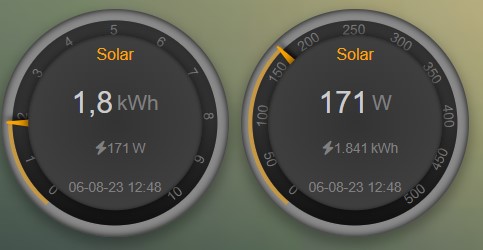

In Domoticz this probably is an energy device. To be sure, can you post the output of:
http://domoticz:8080/json.htm?type=devices&rid=26181
For Energy devices normally the field 'Usage' gives the actual power usage (in W). The total energy usage is provided via 'CounterToday' (in kWh)
Energy devices are handled in a specific way. Not all configuration parameters are used. Normally an Energy dial will display the daily counter as the big number (in kWh) and the actual usage (in W) as a small number below. You can switch this by adding the following as block parameter:
   subtype: 'usage'
Example:
If you want to customize your dial, you can do it as follows:
blocks['Energy'] = {
    idx: 26181,
    type: 'dial',
    title: 'Conso',
    showvalue: false,
    values : [
            value: 'Usage',
            unit: 'W',
            addClass: 'primary'
            value: 'CounterToday',
            unit: 'kWh'
