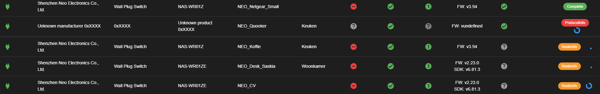

I'm pretty annoyed while moving from a perfect OpenZwave 1.6. to this Zwave-JS-UI.
I now have:
- Not all devices are now KNOWN anymore (Fibaro, NEO)
- Not all devices have all their capabilities (some even don't switch on/off but do report their W , V kWh just fine)
Any tips on how to fix this? I tried re-interview or heal per node.
Range should not be the issue as it worked with OpenZwave in Domoticz.
Seems I am a bit lost with this new tool.
Should I remove some json files and start over ?

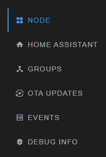

I also notice some devices do have Home Assistant mentioned and others don't.

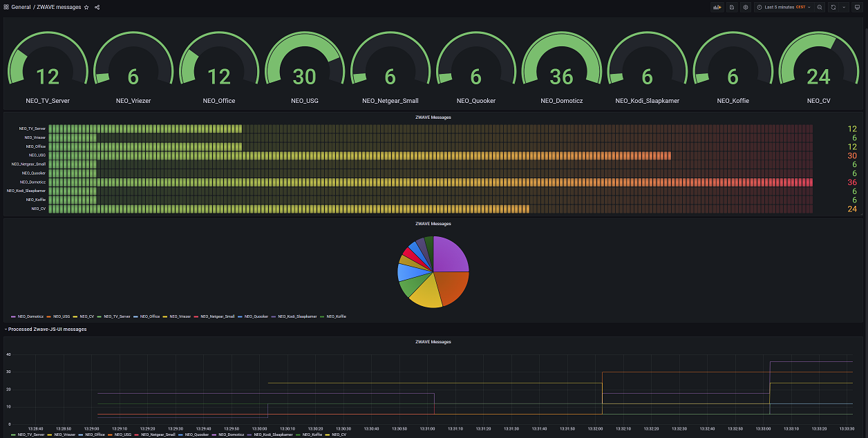

I'm still waiting for days for the full interview to get completed.
I see these round blue circles with 'NodeInfo' & 'ProtocolInfo' for 220v Operated Nodes.
However these nodes are in Domoticz and bring partial data to the table. For example W, kWh however not the SWITCH (On/Off) function.
To help me out if the Network is not to crowded. I created a Grafana dashboard, maybe I can determine the rootcause with that one..
