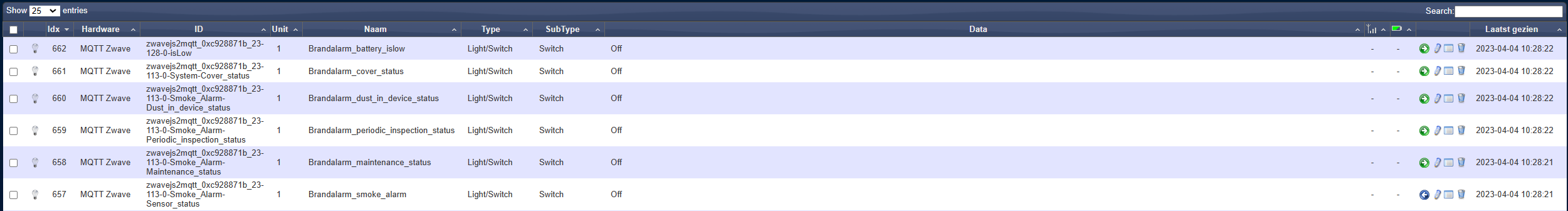

Had some time to spare, and some issues with a zwave node, so gave it another try... Cant get replace to work at all, since i can't have both plugins enabled at the same time. Also, still some devices unsupported.
Thirdly, my smoke alarm got added by MQTT Auto discovery. However, it's not updated rightly.
MQTT shows a change at 10:30, when i pushed the test button:
2023-04-04 10_41_31-MQTT Explorer.png (93.43 KiB) Viewed 6934 times
However, it isn't updating in domoticz:
2023-04-04 10_41_58-Thuis en nog 8 andere pagina's - Profiel 1 - Microsoft​ Edge.png
2023-04-04 10_41_58-Thuis en nog 8 andere pagina's - Profiel 1 - Microsoft​ Edge.png (66.92 KiB) Viewed 6934 times
Any thoughts? Domoticz log is quite empty
