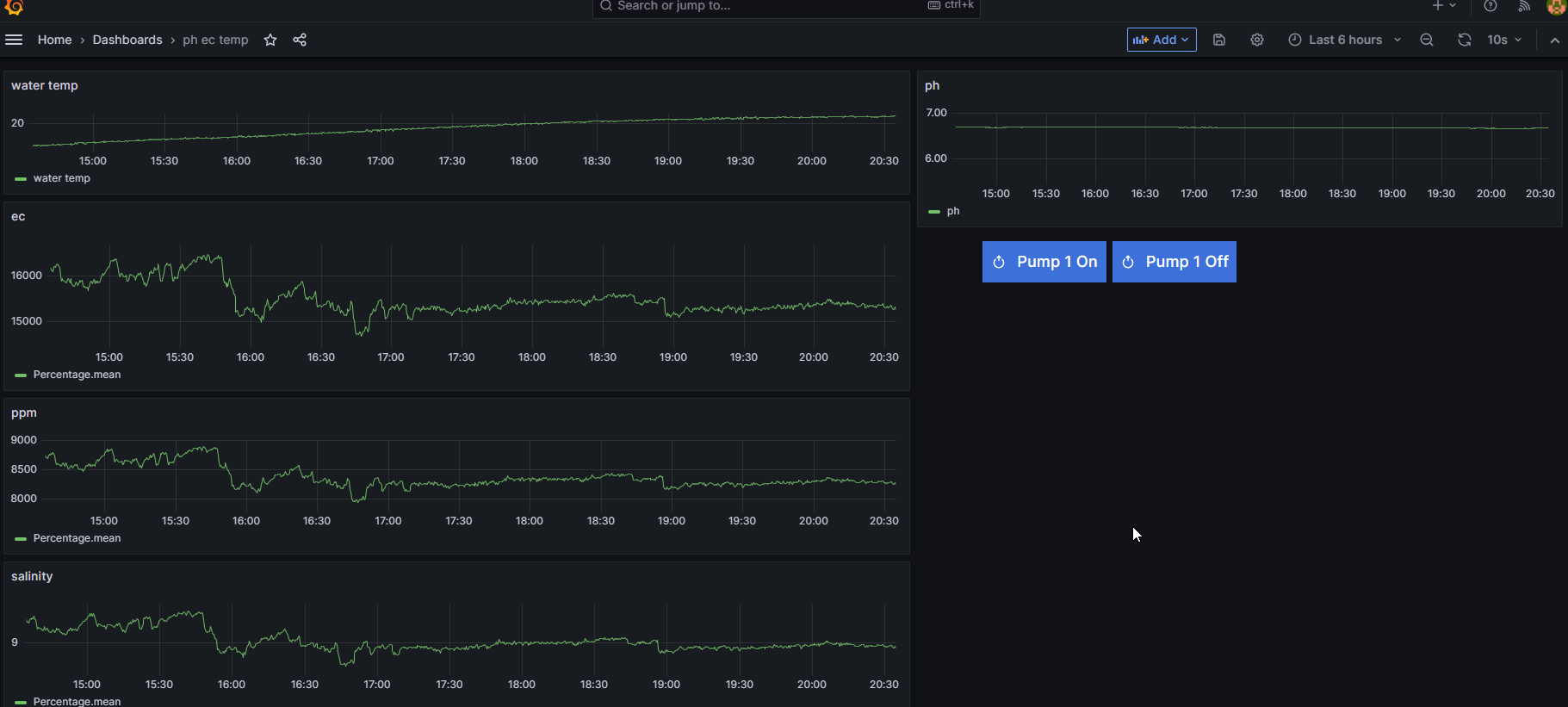

because i'm using a time series graph on grafana :)
