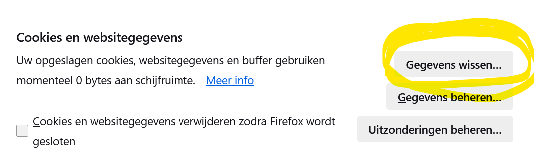

I am a user (not an ADP guru) so my apology up front.
After the update to Version: 2023.2 there was a bit panic.
My scripts (still on the HDD) where not visable,
Scenes where there but could not be editted.
Logout did not help it brought me back to the dasboard.
etc. etc.
reading the topics did not solve a thing (wait a sec)
What helped... I use Firefox, I cleared all the cookies and cashed (?) data within Firefox.
Problem solved
etc. etc.
Problem solved
- Schermafbeelding.png (46.07 KiB) Viewed 1692 times

Yes, that is why I have a big red line in my signature linking to the Browser cache clear instructions: https://www.domoticz.com/wiki/Browser_CacheHcroij wrote: Monday 31 July 2023 17:06 I am a user (not an ADP guru) so my apology up front.
Problem solved
