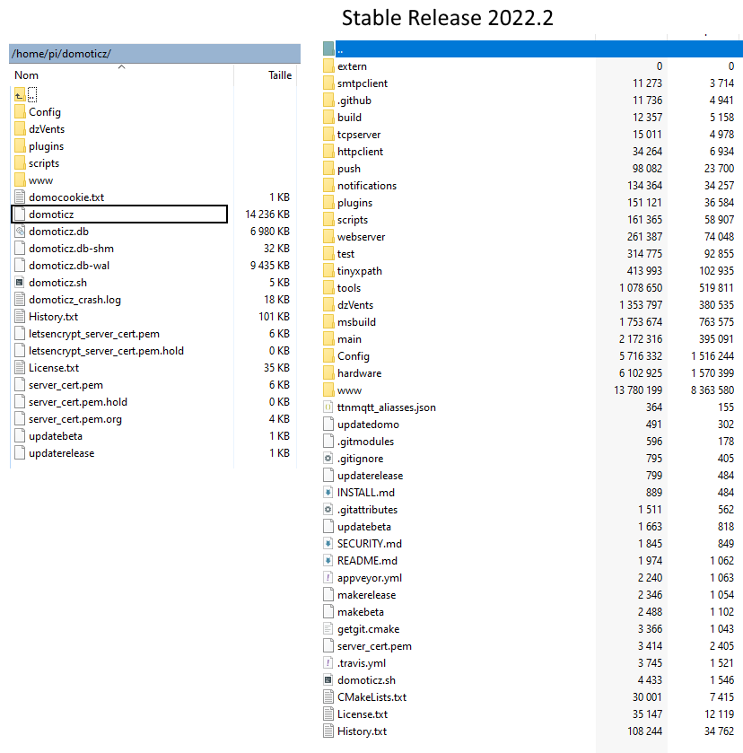

Re: Domoticz downgrade
I already tried but it doesn't work, mainly Domoticz main file is missing" in the releases.
And I don't know where to find the domoticz_linux_armv7l-tgz file in version 2022-1?

Re: Domoticz downgrade from 2023.1 to 2022.2
That because you have to compile it. This creates the Domoticz executable on your platform.
Follow the instructions at https://www.domoticz.com/wiki/Build_Dom ... rom_source
I followed the procedure correctly but it compiles the latest version (2023) ;-(
I would like to compile the 2022 version (domoticz/releases/tag/2022-2)

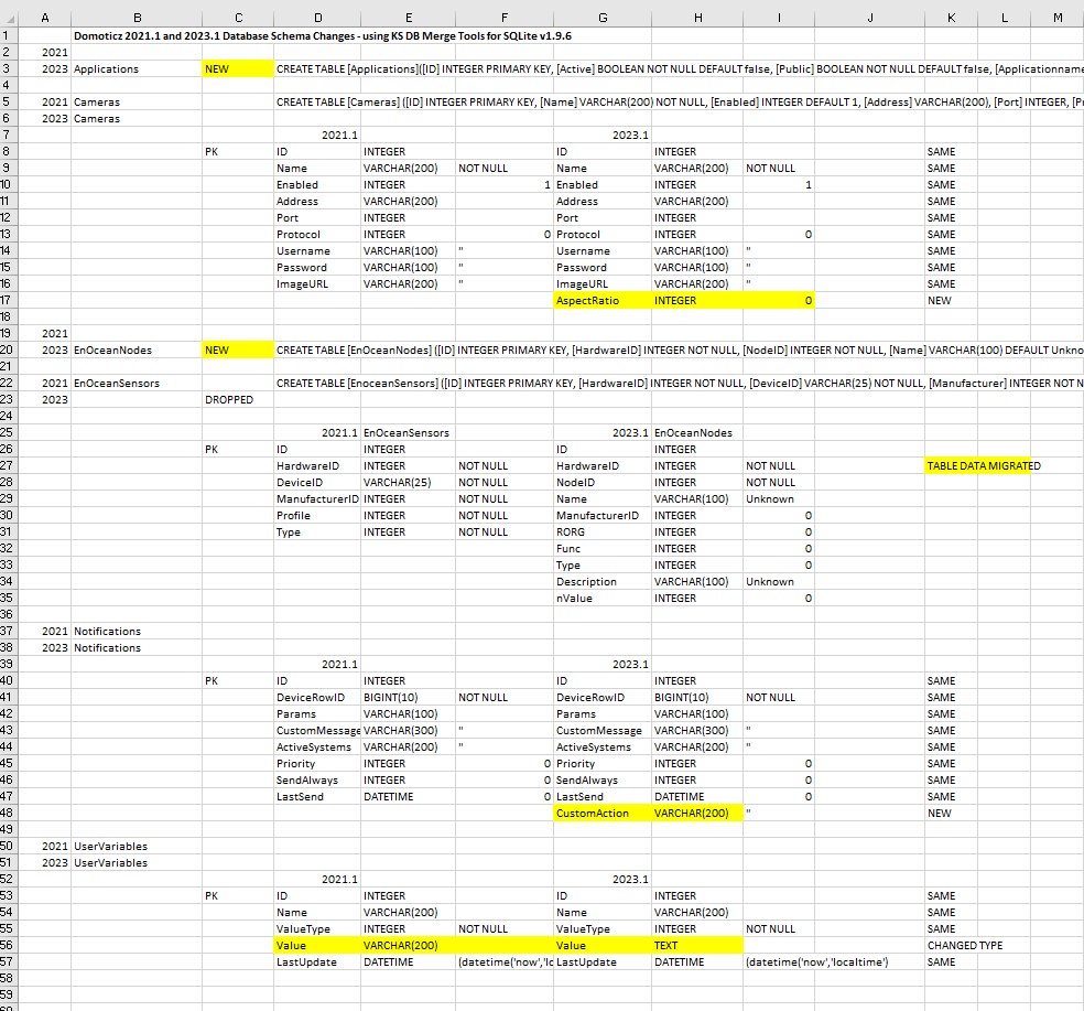

I would definitely not recommend downgrading like this. however your database is still upgraded, you only fooled domoticz into thinking it was not and apparently that works for now. But you might have fucked any future upgrade this way... and then you'r stuck on this version forever...simat wrote: Thursday 20 April 2023 20:43 It is possible, I recently downgraded from 2023.1 right back to 2021.1 due to major problems with a Python Modbus RTU plugin.
Software is here https://github.com/domoticz/domoticz/releases it doesn't include an executable, you have to build it yourself, but that is easy enough by following the instructions at https://www.domoticz.com/wiki/Build_Dom ... rom_source
Obviously make a backup of everything 1st. You might have to do a git pull 1st to get the buildfiles and then extract the relevant source you downloaded over the top.
You then have to edit the domoticz.db file using https://sqlitebrowser.org/dl/ and change the DB_Version to 156 (for 2022.1) and 148 (for 2021.1) in the preference table and then click Write changes. See https://www.domoticz.com/wiki/Domoticz_ ... _-_Commits for database version details.
I built a fresh platform for it all to sit on and it now works perfect.
I hope this helps.
(or manually undo this database version change and then try to upgrade... bit still risky.. you don;t know what was handled the wrong way in the DB which could case vague problems in the future)
simat
- Posts: 33
- Joined: Thursday 04 November 2021 21:17
- Domoticz version: 2023.1
- Location: UK
I deemed it quite safe as I checked the DB schema between 2021.1 and 2023.1 and only minor changes had occured, all of which had no effect on my install. The only big one is EnOceanSensors looks like it got migrate to EnOceanNodes. The other tables effected were Camera with an extra field, Notifcations with an extra field and UserVariable with a data type change. On my system all of these tables were empty so I had nothing to worry about.
I only spent a couple of weeks back on 2021.1 as I managed to fix the Modbus RTU plugin to work in parallel instances on 2023.1 and a 1-wire counter return a zero instead of a null issue, so I've 'upgraded' back to 2023.1 and all is working very nicely now. No problems upgrading and DB version ok too.
I used KS DB Merge Tools to compare the 2 schemas.
- Detail Schema Changes 2021-1 and 2023-1.jpg (266.98 KiB) Viewed 1835 times
