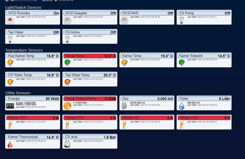

Maybe there is no reason for the script to not perform, but the fact is, it does nothing. This is from the moment I run the 2023.1 update.
I run 3 raspberry/domoticz in total and the one with the Omnik script is "dead" (not the pi/domoticz, but Omnik script, but used on 1 pi only)
When you dive into it , there are more users who have the same problem, something todo with "http get" or something simular.

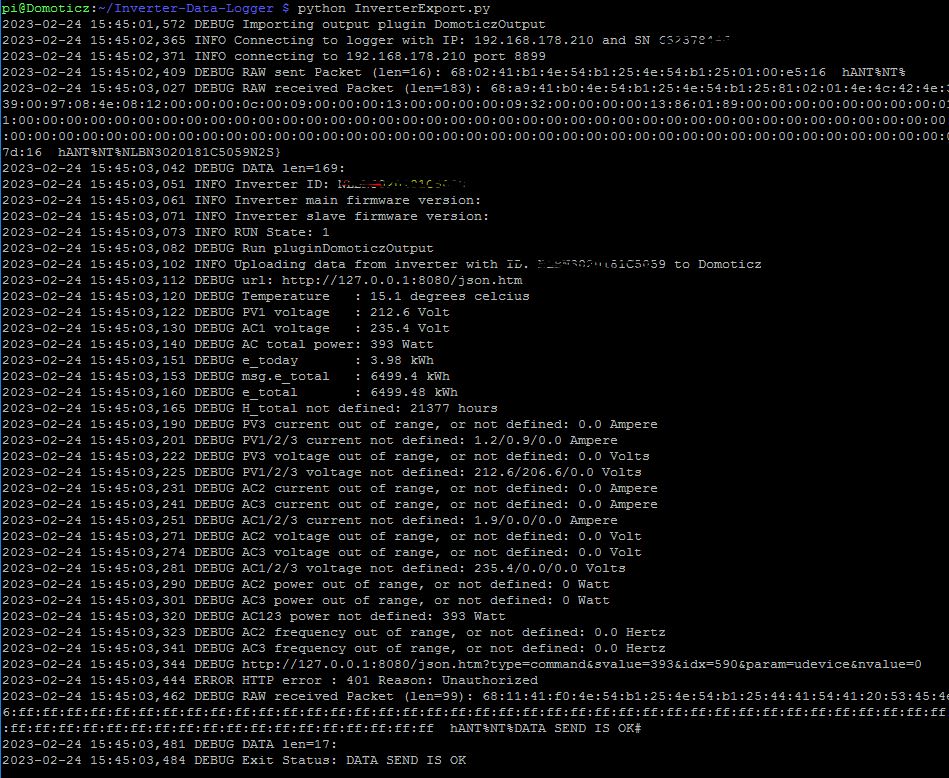

I started running the installation steps 1 by running them like in the setup manual.
The Lines with " DEBUG current out of range" is by design because it is an 1 fase and not 3 fase inverter
Below is the output when I manually run python Inverter-Data-Logger.py
There is a respons from the Inverter, all the data is there , but at the end there is a http error and I don't know how to resolve that....

2023-02-23 17:59:37,110 ERROR HTTP error : 401 Reason: Unauthorized

2023-02-23 17:59:36,252 DEBUG RAW sent Packet (len=16): 68:02:41:b1:4e:54:b1:25:4e:54:b1:25:01:00:e5:16 hANT%NT%
2023-02-23 17:59:36,857 DEBUG RAW received Packet (len=183): 68:a9:41:b0:4e:54:b1:25:4e:54:b1:25:81:02:01:4e:4c:42:4e:33:30:32:30:31:38:31:43:35:30:35:39:00:7a:08:0e:08:04:00:00:00:00:00:00:00:00:00:00:00:00:00:00:08:da:00:00:00:00:13:88:00:00:00:00:00:00:00:00:00:00:01:00:00:00:fd:bb:00:00:53:6d:00:00:00:00:00:00:00:00:00:00:00:00:00:00:00:00:00:00:00:00:00:00:00:00:00:00:00:00:00:00:00:00:00:00:00:00:00:00:00:00:00:00:00:00:00:00:00:00:00:00:00:00:00:00:00:00:00:00:00:00:00:00:00:00:00:00:00:00:00:00:00:00:00:00:00:00:00:00:00:00:00:00:00:00:00:00:00:00:00:00:00:00:00:00:00:00:00:00:00:00:00:00:3f:16 hANT%NT%NLBN3020181C5059zSm?
2023-02-23 17:59:36,868 DEBUG DATA len=169:
2023-02-23 17:59:36,872 INFO Inverter ID: NLBN3020181C5059
2023-02-23 17:59:36,878 INFO Inverter main firmware version:
2023-02-23 17:59:36,881 INFO Inverter slave firmware version:
2023-02-23 17:59:36,896 INFO RUN State: 0
2023-02-23 17:59:36,900 DEBUG Run pluginDomoticzOutput
2023-02-23 17:59:36,905 INFO Uploading data from inverter with ID: NLBN3020181C5059 to Domoticz
2023-02-23 17:59:36,909 DEBUG url: http://127.0.0.1:8080/json.htm
2023-02-23 17:59:36,912 DEBUG Temperature : 12.2 degrees celcius
2023-02-23 17:59:36,916 DEBUG PV1 voltage : 206.2 Volt
2023-02-23 17:59:36,922 DEBUG AC1 voltage : 226.6 Volt
2023-02-23 17:59:36,932 DEBUG AC total power: 0 Watt
2023-02-23 17:59:36,934 DEBUG e_today : 2.56 kWh
2023-02-23 17:59:36,938 DEBUG msg.e_total : 6495.5 kWh
2023-02-23 17:59:36,943 DEBUG e_total : 6495.56 kWh
2023-02-23 17:59:36,948 DEBUG H_total not defined: 21357 hours
2023-02-23 17:59:36,954 DEBUG PV3 current out of range, or not defined: 0.0 Ampere
2023-02-23 17:59:36,956 DEBUG PV1/2/3 current not defined: 0.0/0.0/0.0 Ampere
2023-02-23 17:59:36,962 DEBUG PV3 voltage out of range, or not defined: 0.0 Volts
2023-02-23 17:59:36,967 DEBUG PV1/2/3 voltage not defined: 206.2/205.2/0.0 Volts
2023-02-23 17:59:36,977 DEBUG AC2 current out of range, or not defined: 0.0 Ampere
2023-02-23 17:59:36,986 DEBUG AC3 current out of range, or not defined: 0.0 Ampere
2023-02-23 17:59:36,989 DEBUG AC1/2/3 current not defined: 0.0/0.0/0.0 Ampere
2023-02-23 17:59:36,995 DEBUG AC2 voltage out of range, or not defined: 0.0 Volt
2023-02-23 17:59:37,004 DEBUG AC3 voltage out of range, or not defined: 0.0 Volt
2023-02-23 17:59:37,013 DEBUG AC1/2/3 voltage not defined: 226.6/0.0/0.0 Volts
2023-02-23 17:59:37,024 DEBUG AC2 power out of range, or not defined: 0 Watt
2023-02-23 17:59:37,027 DEBUG AC3 power out of range, or not defined: 0 Watt
2023-02-23 17:59:37,031 DEBUG AC123 power not defined: 0 Watt
2023-02-23 17:59:37,035 DEBUG AC2 frequency out of range, or not defined: 0.0 Hertz
2023-02-23 17:59:37,043 DEBUG AC3 frequency out of range, or not defined: 0.0 Hertz
2023-02-23 17:59:37,048 DEBUG http://127.0.0.1:8080/json.htm?type=com ... e&nvalue=0
2023-02-23 17:59:37,122 DEBUG RAW received Packet (len=99): 68:11:41:f0:4e:54:b1:25:4e:54:b1:25:44:41:54:41:20:53:45:4e:44:20:49:53:20:4f:4b:0d:0a:23:16:ff:ff:ff:ff:ff:ff:ff:ff:ff:ff:ff:ff:ff:ff:ff:ff:ff:ff:ff:ff:ff:ff:ff:ff:ff:ff:ff:ff:ff:ff:ff:ff:ff:ff:ff:ff:ff:ff:ff:ff:ff:ff:ff:ff:ff:ff:ff:ff:ff:ff:ff:ff:ff:ff:ff:ff:ff:ff:ff:ff:ff:ff:ff:ff:ff:ff:ff:ff hANT%NT%DATA SEND IS OK#
2023-02-23 17:59:37,136 DEBUG DATA len=17:
2023-02-23 17:59:37,144 DEBUG Exit Status: DATA SEND IS OK

The problem is still there. The error you pointend was for file access: inverter-export.log (that is fixed), but I still don't have the Omik PV reading running.
This is the Omnik script I use:
https://github.com/XtheOne/Inverter-Dat ... /README.md
When I run the 2 python scripts I get 1 good and 1 bad reply.
python LiveStats.py python InverterExport.py At the bottom you see de error;
You say the security update was also in 2022.2. I don't know if I came from 2022.1 or 2022.2. Mostly I do the update after 1 or 2 weeks because the "there is an update available" POP-UP is getting irritating

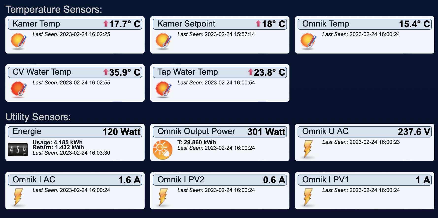

I think I just "fixed" it........ I hope (?)
I replaced the 127.0.0.1 with the actual IP of the Pi .
I run both Python scripts, and I get Omnik output reading (Watt, Voltage, Ampere, Temp)
I am very happy
I am very happy

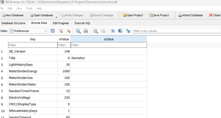

It is possible, I recently downgraded from 2023.1 right back to 2021.1 due to major problems with a Python Modbus RTU plugin.
Software is here https://github.com/domoticz/domoticz/releases it doesn't include an executable, you have to build it yourself, but that is easy enough by following the instructions at https://www.domoticz.com/wiki/Build_Dom ... rom_source
Obviously make a backup of everything 1st. You might have to do a git pull 1st to get the buildfiles and then extract the relevant source you downloaded over the top.
You then have to edit the domoticz.db file using https://sqlitebrowser.org/dl/ and change the DB_Version to 156 (for 2022.1) and 148 (for 2021.1) in the preference table and then click Write changes. See https://www.domoticz.com/wiki/Domoticz_ ... _-_Commits for database version details.
I built a fresh platform for it all to sit on and it now works perfect.
I hope this helps.
I hope this helps.
- SQL-DBedit194159.jpg (70.67 KiB) Viewed 3263 times
