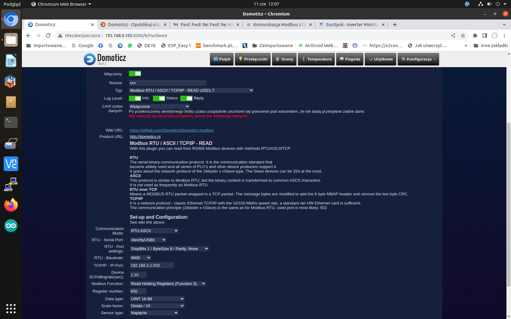

marcin81233
- Posts: 3
- Joined: Saturday 06 May 2023 20:54
Re: Python plugin: Modbus RTU / ASCII / TCP/IP
Can someone help me convert the plugin so that it downloads data from the deye inverter?

marcin81233
- Posts: 3
I'm a novice in such matters. Could you write what I should enter in the appropriate fields in domoticz from this frame?simat wrote: Sunday 07 May 2023 9:57 Is your inverter Modbus RTU or Modbus TCP ?
Someone suggested that the Deye Inverter is the same as Sol-Ark ?
Either way the Modbus RTU/ASCI/TCP plugin mentioned in this thread should do the trick without modification, you just need to know the modbus slave ID, register address and data type for starters.
- Zrzut ekranu z 2023-06-11 12-07-02.png (274.68 KiB) Viewed 4861 times
- Bez tytułu 1.pdf
- (241.15 KiB) Downloaded 98 times
