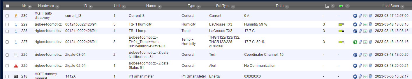

Re: Another Zigbee TRV (TS0601)
I think your issue was the device was not fully removed.
You need to remove all domoticz widget, then check on the plugin device management that the device is removed and if not you should have a Trash icon to remove it
I removed the TRV device but not the plugin devices: screenshot is what I have now.l
