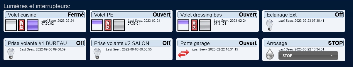

Hello, when I restore my DB on my new NAS DS718+ I have this error: 'Error sending switch command, check device/hardware (idx=nnn) !' may be the 'Error opening serial port is the cause'. But why ? /dev/ttyUSB0 is done for the RFXcom. Thank's for your help

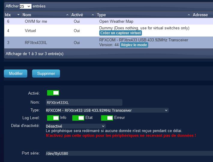

Did you set the USB device correctly in menu Setup - Hardware - RFLink?
It probably changed name when using another Synology.

Yes, for me RFXtrx433XL is correctly set :
and USB is activated at reboot by a scheduler task.

Errors from Lamps & Switches (RFXcom)

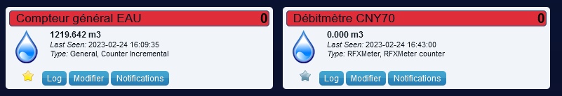

No update for these devices (Water meter X10 RFXcom)

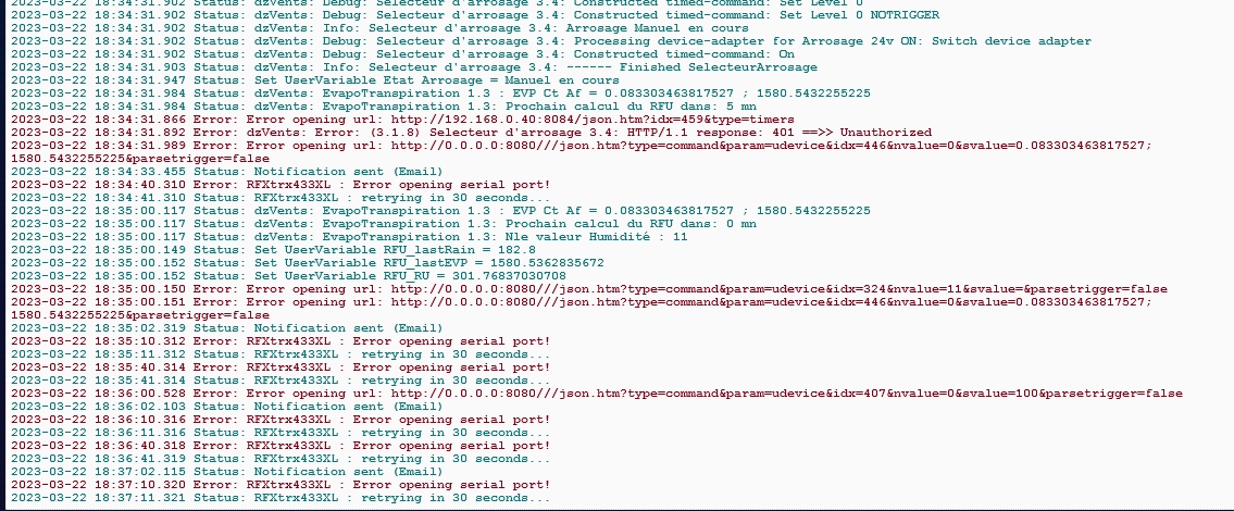

View log with errors serial port and JSON

Yes there seems to be a communication error with your USB device. I am not familiar with Synology but it seems that on newer Linux environments you have usb devices by IDwhat do you see when you open the Port pull down list from the hardware setting? Do you see more USB devices next to ttyUSB0?
The Dzvents error can be solved by setting your security settings correctly, especially trusted networks and switch on basic auth over http. https://www.domoticz.com/wiki/Security
