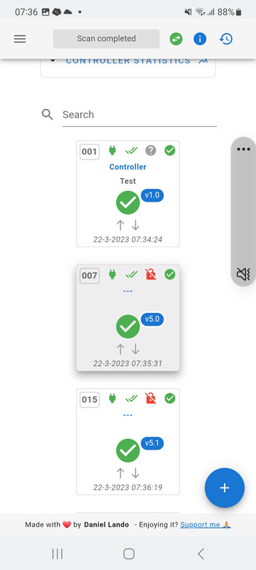

<ipofmachine>:8091
I have made some settings there and i See look at image.
I setup the security key.
But no devices are vissible in Domoticz. I dont understsnd how to do these settings. I tried with MQTT discover but i don't understand how to setup.
