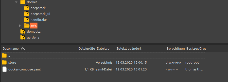

thomasbaetge
Posts: 153
Joined: Wednesday 02 October 2019 11:47
Domoticz version: 2023.1
Location: DE / BY / LT
Re: Zwave JS- UI install how. Help please!
Post by thomasbaetge »
I don't think you need to remove docker.
there is an error in your file above:
- "/dev/serial/by-id/usb-0658_0200-if00-port0:/dev/ttyACM0"
Should probably read:
- "/dev/serial/by-id/usb-0658_0200-if00:/dev/ttyACM0"
I think we had that before, Walter pointed this out in the other thread.
thomasbaetge
Posts: 153
there is no need for a fresh install and I assume, your docker installation is fine.
Please see my folder structure vor the various docker containers that I am running below. It's not a Raspberry, but a NUC, but the process is the same.
there is always one folder for each image, inside is the respective docker-compose.yaml and required subfolders for persistant data storage.
This is REALLY simple.
Bildschirmfoto vom 2023-03-21 13-47-14.png (25.64 KiB) Viewed 4040 times
ok but these docker-compose.yml file version 3.3 is not there.
Ok but /zwjs docker compose up Is not possible because its running another zwave with that name.
Its not possible for me i think so.

I don't understand.
if you have a zwjs container up and running, what is the problem then?
