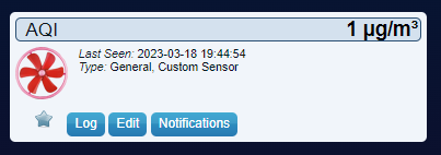

turns on a switch every time the air sensor value is 12
Post by betogar »
I want to make a script that turns on a switch every time the air sensor value is 12 or higher and turns off when it is 11 or less
I am using a custom sensor for air quality
try this but it gives error
Captura de pantalla 2023-03-18 120316.png (7.07 KiB) Viewed 1326 times
