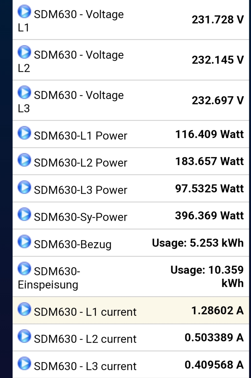

It looks to me as well that the Eastron SDM 630 Plugin is faulty in the value of current. It does not
Display the same value as on the meter directly.
- Look at current and power L1
- IMG_20230301_203758.jpg (308.13 KiB) Viewed 605 times
