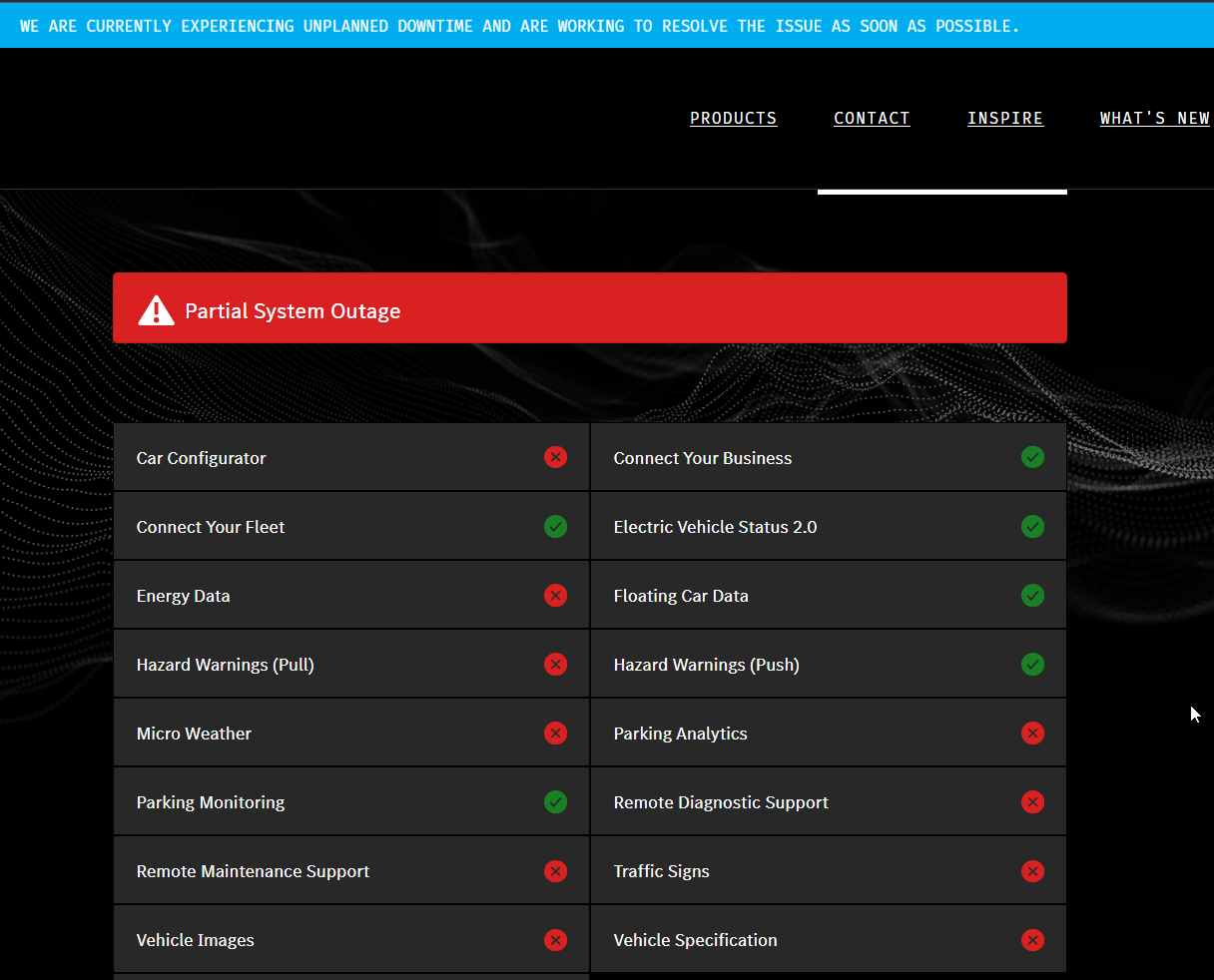

frankdep
Posts: 12
Joined: Saturday 14 September 2019 10:14
Re: Mercedes Me (Connected Vehicle)
Post by frankdep »
Server is actually down since Friday 14/4/2023 18:51
https://developer.mercedes-benz.com/status
2023-04-17 18_42_11-Clipboard.png (209.95 KiB) Viewed 2567 times
jeroenbs
Joined: Monday 06 February 2023 14:24
Post by jeroenbs »
Yes, first I thought, something wrong here. I have the same problem
frankdep
Posts: 12
Post by frankdep »
Back online since 18/4 2:07, All OK now
