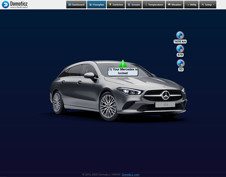

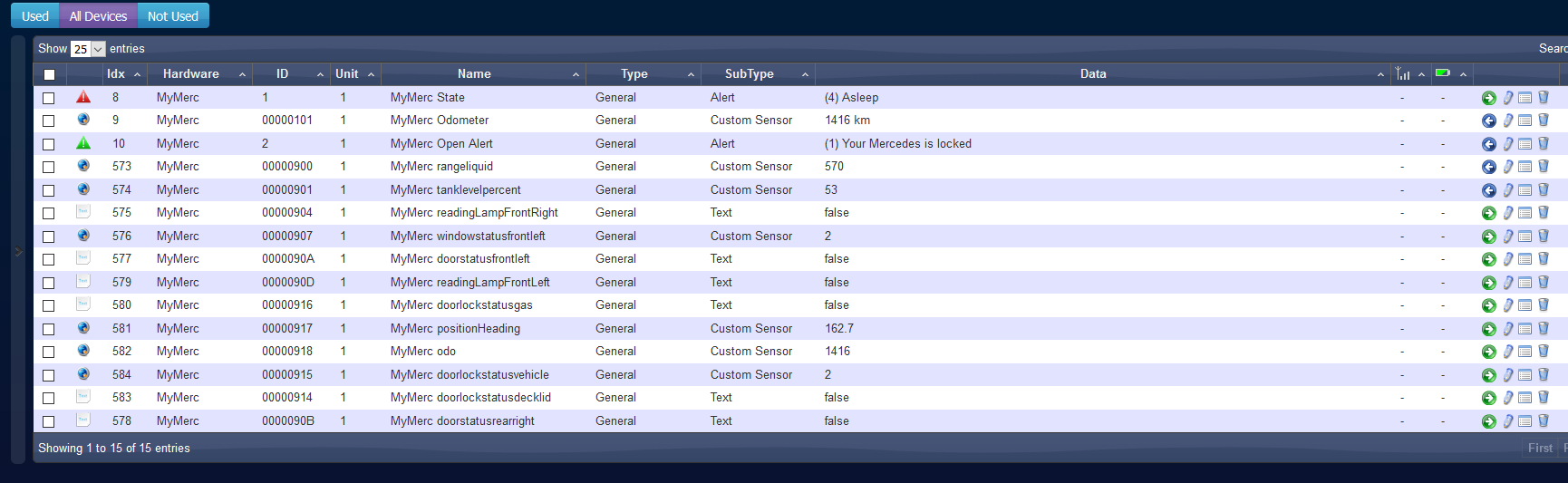

Some screenshots (beta):

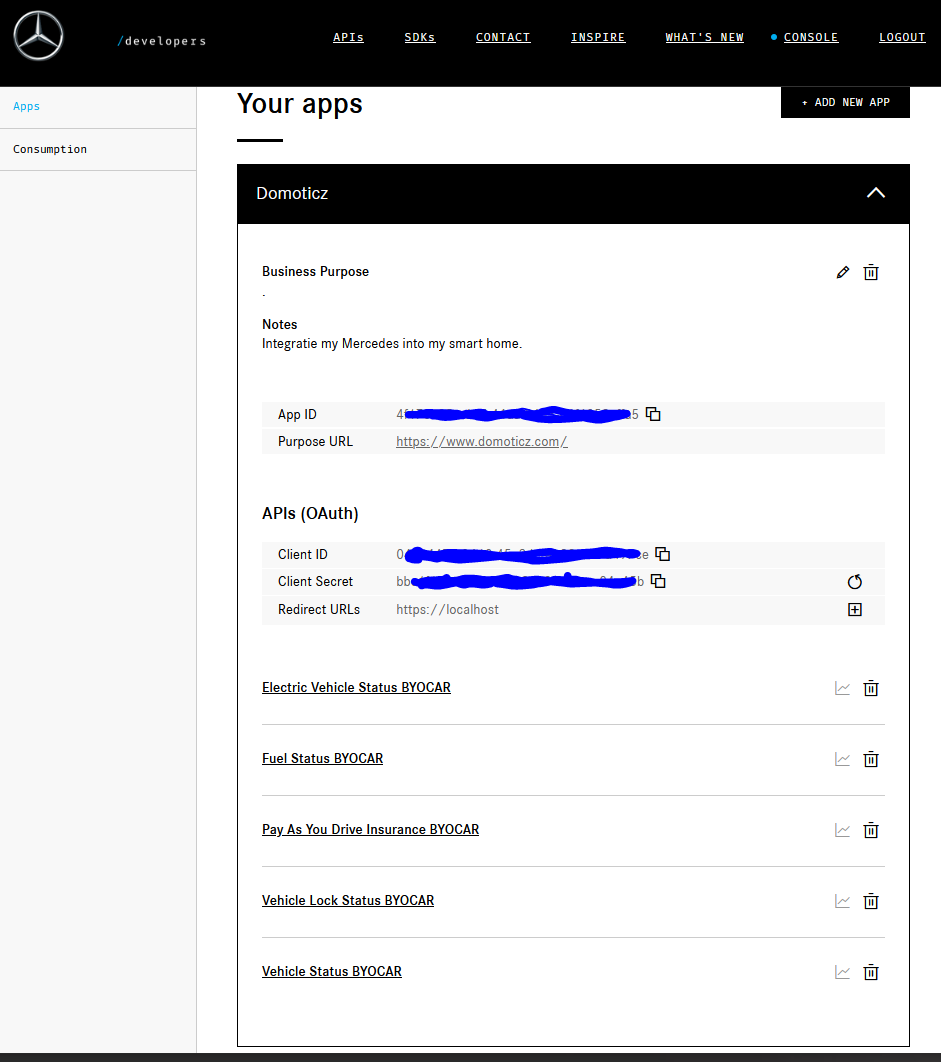

@JimmyH1969, I assume you have been able to login to the Developers portal using your Mercedes Me account? (Must be the same one that you use in the app and has been registered with your car. In my case that was done by the dealer as they are I think the only ones that can bind a/your car to your account). Is that correct?
Within the developers portal you need to access the 'console'. Here you see your information.
  • First you need to have/create an App. Can be anything and you only need 1, I called mine Domoticz but any name is fine.
  • The purpose URL can also be anything. I just linked to the Domoticz website.
  • Once you have an app, now you can choose one of the API and press 'Get Access'. Here select the created application to link the API to this APP.
  • If you look in the Console now, you see within the APP that an API section is added which shows the API you now have access to, but also shows the OAuth2 credentials you need consisting of a Client ID and Client Secret. These are important.
  • For OAuth, you need to add a Redirect URL which you can do in the Console. Create a Redirect URL with the value https://localhost
  • At this moment, for 5 API's a BYOCAR license can be requested and added to your console.
Once you have the licenses for these 5 API's added to your App (should be visible in the console), it becomes possible to start the OAuth2 authorisation process.

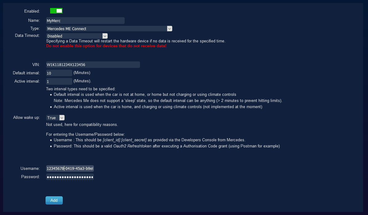

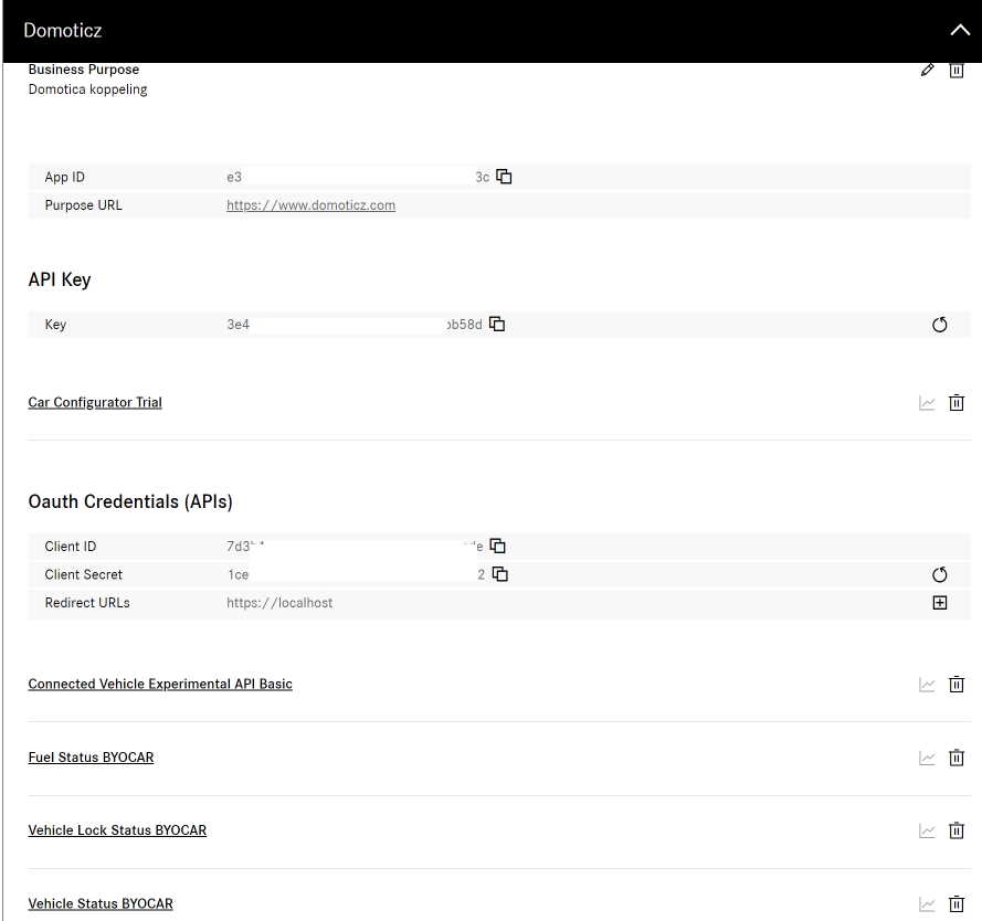

I've included some screenshot's maybe someone else can see my mistake.
This is the errors i've got:
2020-08-31 18:40:41.819 Status: Received 400/401.. During authorisation proces. Aborting!
2020-08-31 18:40:41.819 Status: Mercedes: Aborting due to too many failed authentication attempts (and prevent getting blocked)!
2020-08-31 18:40:41.819 Status: Mercedes: Worker stopped...
2020-08-31 18:40:41.819 Error: MercApi: Failed to get token.
2020-08-31 18:40:41.819 Error: MercApi: Failed to refresh login credentials.
I've been curious what mistake i'm making here ;)
kiddigital
Posts: 438
Re: Mercedes Me (Connected Vehicle)
Post by kiddigital »
sieth wrote: Monday 31 August 2020 18:42 Ok, so clearly I did something wrong than.
I see you have 3 of the 5 BYOCAR licenses added to your profile. Add EV (even if you don't have an EV) and Pay-as-you-Drive.
sieth wrote: Monday 31 August 2020 18:42 merc2.jpg
Looks ok. Just to double check: username contains both the client_id AND client_secret with a colon in between?
sieth wrote: Monday 31 August 2020 18:42 merc3.jpg
Nice :) With each change in licenses (and/or when some time (few hours) has passed) you need to re-do this to get a new authorization code as the current/old ones expires.
sieth wrote: Monday 31 August 2020 18:42 This is the errors i've got:
At the above log is indeed saying that the authorization process fails.
At the moment the process is not really user-friendly yet (trying to work on that :oops: ).
The 'missing' step, I will update the docs asap, is that although the setup screen already says that you need to enter the Authorisation code you received (which you did in screenshot 3), you still have to enter the 'refresh token' (or you can enter the refreshtoken within the 'user variables', see setup/more options/user variables). Therefor you need to perform one more step once you have a valid Authorisation code:
curl --location --request POST 'https://api.secure.mercedes-benz.com/oidc10/auth/oauth/v2/token' \
--header 'Authorization: Basic <BASE64 Encoded client_id:client_secret>' \
--header 'Content-Type: application/x-www-form-urlencoded' \
--data-urlencode 'code=<PUT_YOUR_AUTHORISATION_CODE_HERE>' \
--data-urlencode 'redirect_uri=https://localhost' \
--data-urlencode 'grant_type=authorization_code'
The above command (you can run it on your PI or most other shells) has 2 items to fill-in correctly. The AUTHORISATION_CODE from the previous step. And a base64 encoded representation of the string you entered in the 'username' field of the setup screen. You can use base64encode.org (privacy mode just to be sure) or a command like
echo '<client_id>:<client_secret>' | base64
The curl command should return JSON output with contains several things including an access_token and refresh_token. The refresh_token value is the one that you have to enter. When you press 'update' in the setup screen, Domoticz will restart the Mercedes Me hardware and the new value will be used. Within the log you should see a log message stating that login was succesful (and for now also logs the new refresh_token it received and stored internally).
I hope to remove the need for this step asap and let the program take care of this.

At the moment, the Mercedes API's are available and stable again :)
In Domoticz Beta build 12400 and up (today 12449 can be downloaded) an update has been introduced that switches to the new Authentication API Mercedes recently introduced. Everything works fine now, but the first step in getting an Authorization token has a different URL now:
https://id.mercedes-benz.com/as/authorization.oauth2?response_type=code&client_id=<PUT-YOUR-CLIENT-ID-HERE>&redirect_uri=https://localhost&scope=mb:vehicle:mbdata:vehiclestatus%20mb:vehicle:mbdata:fuelstatus%20mb:vehicle:mbdata:payasyoudrive%20mb:vehicle:mbdata:vehiclelock%20mb:vehicle:mbdata:evstatus%20offline_access&state=test
Fill in your clientID and put it into your browser. You should get the Mercedes Me login page and after succesfull login, you should be redirected to a localhost URL containing the token.
(I will update the URL in the opening post as well)
