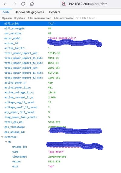

Thanks for the reply to this issue...
Everything is working; Phone APP and Browser.
Why is it suddenly not reading?
P1 JSON_401.jpg (46.58 KiB) Viewed 4245 times

Make an issue on the GitHub repository of the plugin https://github.com/Eraser3/HomeWizard-Wifi-p1-plugin

AthomeDomotica wrote: Saturday 07 January 2023 11:34 Why is it suddenly not reading?
Ah, got it, you are using a plugin, I cannot awnser that.
The method I described is using the built-in http poller.
A hint: blur your unique ids.

waltervl wrote: Saturday 07 January 2023 12:19 Make an issue on the GitHub repository of the plugin https://github.com/Eraser3/HomeWizard-Wifi-p1-plugin
Thanks for the responce.
I've made a Issue on Github for this. I hope for responce, lets see?
"Eraser3/HomeWizard-Wifi-p1-plugin Failed to read response data"
Cheers,
Mike
