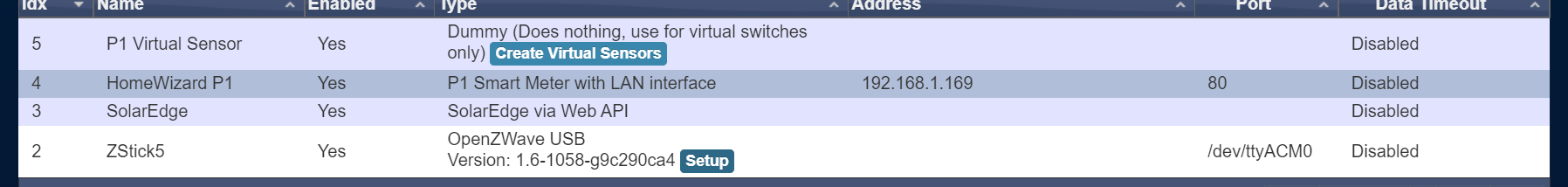

I have a Homewizard P1 Dongle, connected via Wifi to my LAN. When I access the device via the browser, I get something like this:
http://192.168.1.169/api/v1/data
{"smr_version":50,"meter_model":"Sagemcom XS210 ESMR 5.0","wifi_ssid":"xxx","wifi_strength":68,"total_power_import_t1_kwh":6566.39,"total_power_import_t2_kwh":5230.154,"total_power_export_t1_kwh":106.717,"total_power_export_t2_kwh":228.224,"active_power_w":-1616,"active_power_l1_w":-1616,"active_power_l2_w":null,"active_power_l3_w":null,"total_gas_m3":2154.48,"gas_timestamp":210905105000}
I'd like to get this data into Domoticz (running in Docker on a synology), but I'm not entire sure how this is done. I tried adding the "P1 Smart Meter with LAN interface" (which sounds exactly like what I want) and pointed it to the above IP on port 80. In the log I see the following entries, but when I look under Setup/Devices, there is no entry related to the P1 Lan Device - which is unexpected.
2021-09-05 02:17:19.780 Status: P1MeterTCP: attempt connect to 192.168.1.169:80
2021-09-05 02:17:19.787 Status: P1MeterTCP: connected to: 192.168.1.169:80
The other approach I've seen mentioned is to use a "Dummy Virtual Sensor" under Setup/Hardware and then add "Gas" and "P1 Smart Meter Electric" as sensor. These two then do appear under Setup/Devices, but don't report any data (which is kind of obvious, since I didn't find a way to point them to the correct IP to read their data from).
What is the correct way to do this, could someone give some pointers?

But..., you will never receive a valid answer, as the answer from the Homewizard P1 dongle is completely different from what Domoticz expects.
The "P1 Smart Meter with LAN interface" expects a protocol from Netbeheer Nederland B.V.
See: https://www.netbeheernederland.nl/_uplo ... fce1f1.pdf
But what you receive is very nice and is excellent for Node Red.
I copy/pasted your example in an "Inject" node and it gives a nice JSON output.
If you replace the "Inject" node with a HTTP request node, followed by a "Function" node, where you convert the values to the suitable format for Domoticz, you can use either HTTP or MQTT to Domoticz.

Thanks for the replies, I'm getting data which appears valid using http-polling and the lua-script - inside domoticz, so that's something already.
Vaguely heard of mqtt but never heard of node-red. Since multiple people mentioned it I'm curious.
What is the advantage of using mqtt/node-red compared to just letting domoticz handle everything?
