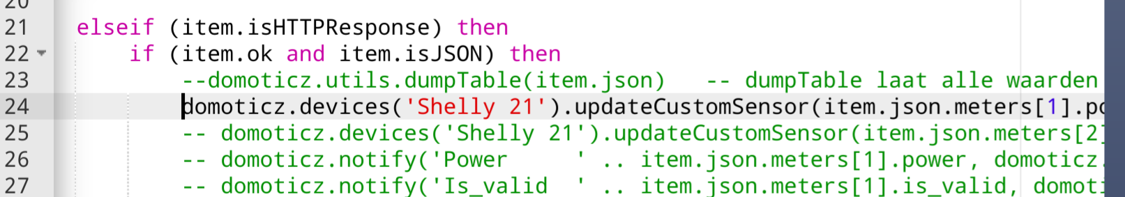

Re: Reading setpoint from Shelly TRV
Post by HvdW »
Maybe dump table gives the information you need.
