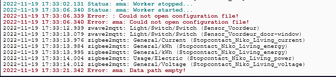

Hello
everything run in docker envoirement.
No i just setup sbf spot in a new docker and setup the domoticz plugin.
But i got this error
2022-11-19 18:40:21.768 Error: sma: Data path empty!
MY path go the the correct config file and my DB is not Empty so sbf works
Any idee's

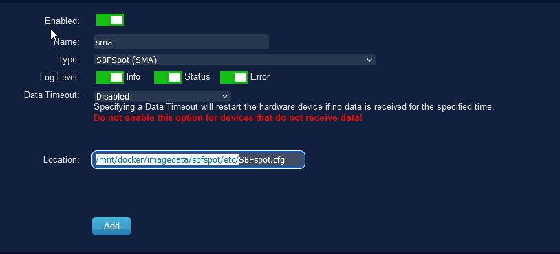

Re: sbfspot empty data path
As you are in a Docker you have to specify the location of the cfg file as you are in docker and not from the point of view outside the docker.

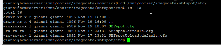

Hey WalterVL
Now i'm lost how can i point to the file inside the container from outside?
grts Gianni
Posts: 6680
Domoticz version: 2025.1
I am not a Docker fan, just for this reason. Making everything a bit more complex. And as there are more docker versions of Domoticz each behaves different...
So the cfg file needs to be accessible from Domoticz in the docker. There are more docker users that can explain where it should be.
