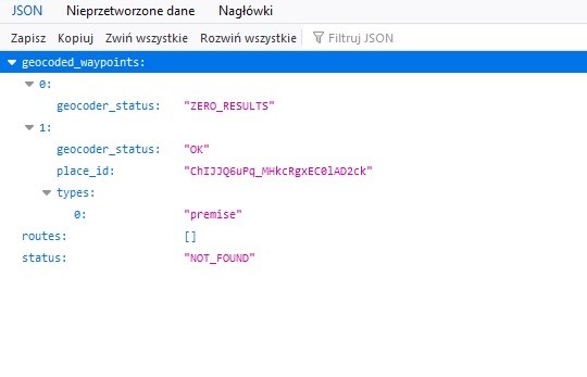

after filling in the data, he gets a replywaltervl wrote: Tuesday 18 October 2022 13:10 Perhaps related to google not accepting normal user/password anymore? You need to make a specific app login on your google account.

Additional: is the link in a browser with filled in parameters for FROM, TO and KEY giving the expected result?Code: Select all
"https://maps.googleapis.com/maps/api/directions/json?origin=$FROM&destination=$TO&transit_mode=driving&departure_time=now&key=$KEY"
geocoded_waypoints
0
geocoder_status "ZERO_RESULTS"
1
geocoder_status "OK"
place_id "ChIJJQ6uPq_MHkcRgxEC0lAD2ck"
types
0 "premise"
routes []
status "NOT_FOUND"
- Posts: 6683
- Domoticz version: 2025.1
Re: Travel time plugin
Based on the result of the link it seems that the Google api changed or that one of the adresses cannot be found. There should be a JSON with a duration_in_traffic.value.

It seems to me that the API key is ok because on the Google website it shows the query in the statistics and the result after loading the link is as if the data were bad ... I don't know I have to do more.
- api.jpg (24 KiB) Viewed 1110 times
- Posts: 6683
You have to play a little bit with the URL to see if it still works. It seems that the first address probably in Warszawa cannot be resolved (ZERO_RESULTS), the second address (in Marki) is OK.
