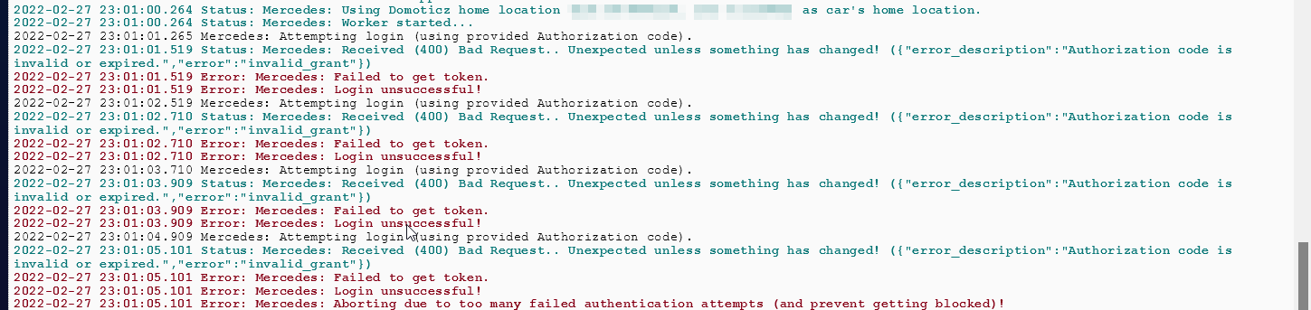

can someone help me out
I still got this error
error ME.png (54.36 KiB) Viewed 3489 times
steps i did
register a app
Get client id en secret.
Go to the url with the client id
logged in with my account
Get a authentication code
Paste ID:Secret into domotoicz
PAste auth into domoticz
into Me settings remote retrevale is active
I already try 3 different auth codes

It seems that somehow the code is not accepted as a valid code.

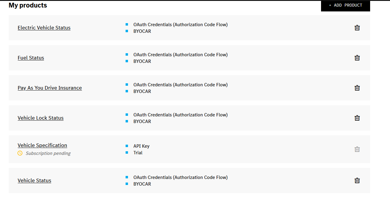

Make sure you have activated all (5) API’s. Can you show a screenshot of the Mercedes Dev portal with all your licenses? (Like at the top of this post)

here is a screenshot of the dev console.
I try to remove the spec module but cannot do this because it's still pending.

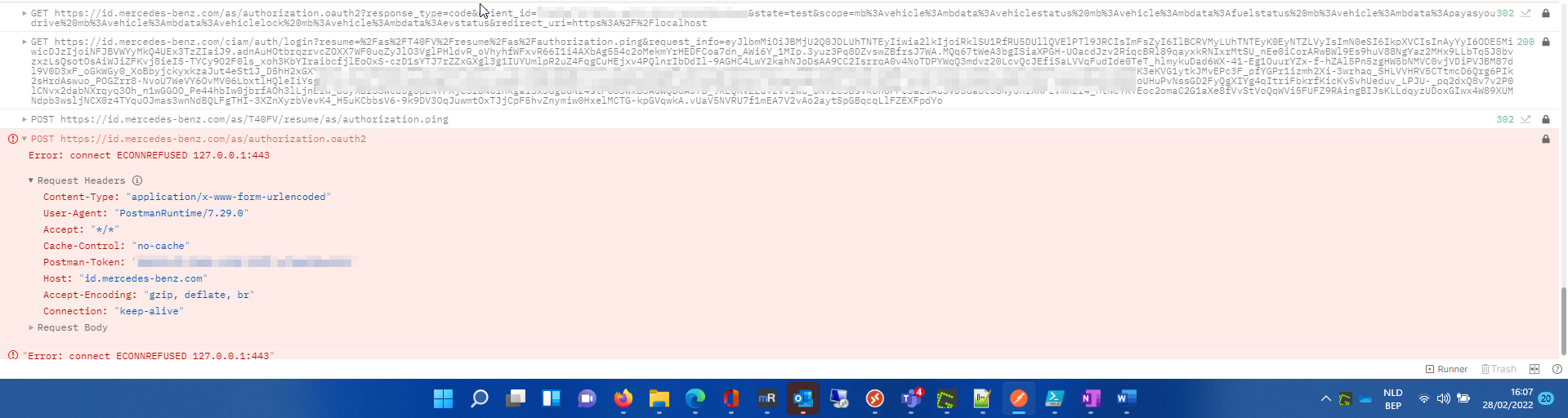

Try it with postman but also a connection refused
error ME2.png (201.88 KiB) Viewed 3473 times

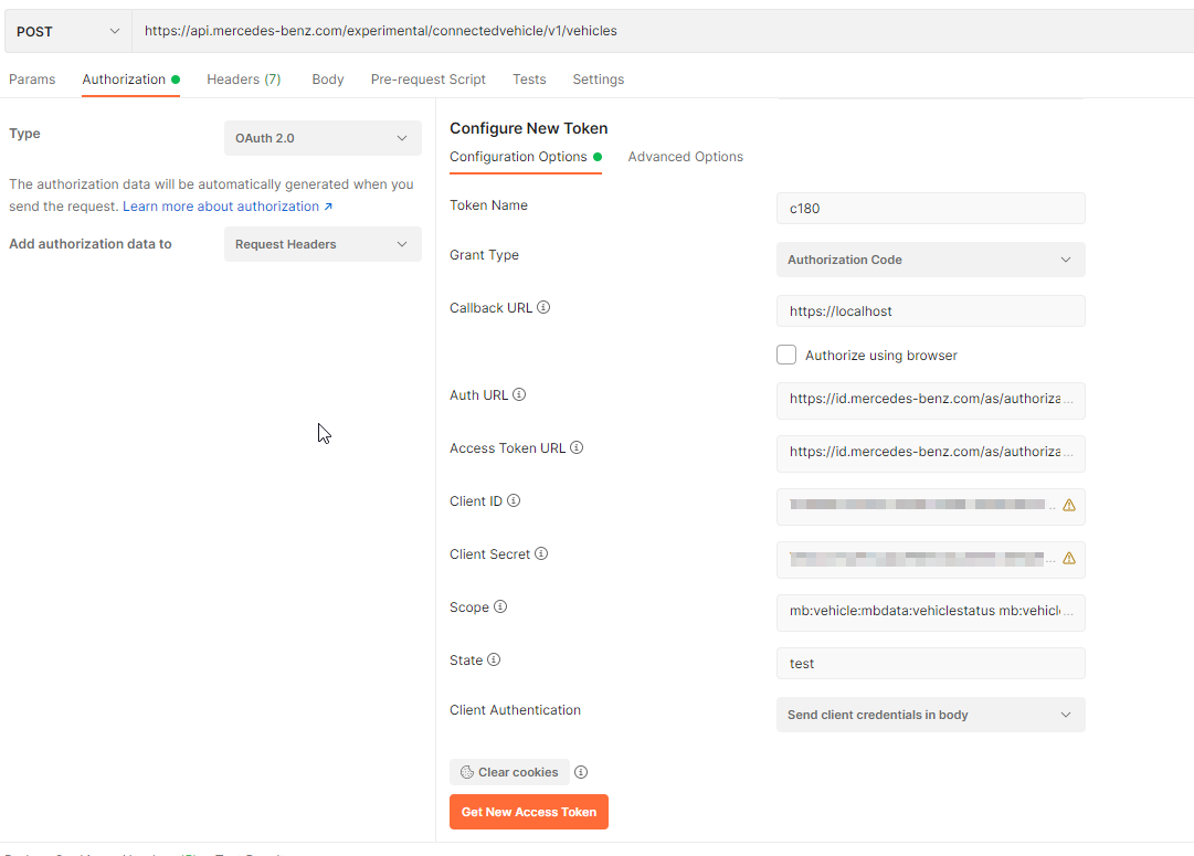

and this is my postman token config
