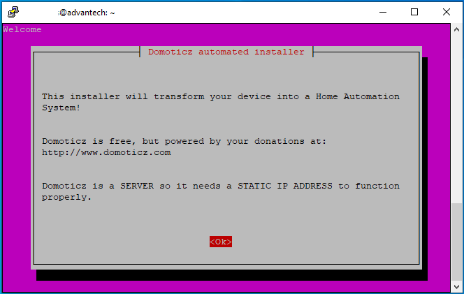

I am trying to install Domoticz through SSH (using Putty) and when the installation 'welcome' dialog is shown (see attachment) it seems that it is not possible to press the 'OK' button.
I tried pressing the following input methods:
  • Tab: many times, no response
  • Enter: after many presses, it results in black lines being added at the bottom
  • Mouse: no response
None of the attempts above result in being able to select or press the 'ok' button. Only by pressing Ctrl+C I'm able to exit the dialog.
Since my first suspect was that it might be related to Putty, I tried other methods to connect through SSH (cygwin, and Ubutu WSL); they all show the same behaviour. In addition, I tried it directly on the PC by connecting a keyboard and monitor (instead of using SSH) and it also shows the same behaviour.

Instead of using the pre-compiled version, I build Domoticz from source, now it's working. So, I think there was an error at the background which was not displayed on the terminal.

[tab] to select and [space] to confirm works for me on RPI 4 via VNC
