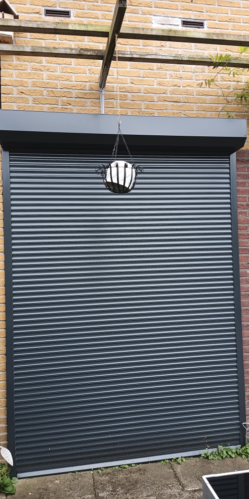

hestia wrote: Sunday 12 June 2022 13:02 What kind of blind(s) do you have? A picture? A feedback?
Sure.
I have 6 roll hatches.
2 situated on the south and 4 on the North.
The ones on the north I use to blind them when in the summer the sun shines through the window.
And of course in the winter to hold the warmth inside as much as possible.
This one is situated on the northside.
hestia
Posts: 361
Joined: Monday 25 December 2017 23:06
Domoticz version: 2022.1
Location: Paris
Re: blinds move on the sun
Post by hestia »
Thank's!
so you use
['BLIND_TYPE'] = 'V'
['SLAT_DOWN_ANGLE']  = -90,     -- Angle from the horizontal when the slat is down (<0), -90 for vertical blind
 ['SLAT_UP_ANGLE'] = 90,         -- Angle from the horizontal when the slat is up, 90 for vertical blind
['SLAT_LENGHT']  = '',          -- Length of the slate, any unit (cm...), nil for vertical blind
['SLAT_DISTANCE']  = '',        -- Distance between slates, any unit (cm...), nil for vertical blind
['BLIND_ANGLE']  = 90,          -- Angle of the blind from the horizontal (>0)
['TTC_SLAT_SEC'] = 1

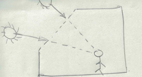

a new change (1st post)
17/06/2022 - remove cosIncidence from the sunRadiationValue: thru a glass at any inclination, the sun strike a body the same?
So that I use the full radiation w/o taking into account the inclination of the windows, because by the end the sun go thru the windows and strike your body directly

hestia wrote: Monday 20 June 2022 20:04 a new change (1st post)
I think it is a good idea to close the blinds the moment the sun strikes the window and open them if the sun does not strike it anymore. It will defenately keep the house cooler.
