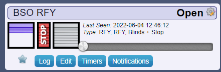

Both do show up in Domoticz like yours initially, but if you go into the device's properties (the 'aanpassen' button in Dutch) you can change the switch type to 'Blinds Inverted + Stop'.
I could configure it, but the slider is not working (not clickable), perhaps because it is RFY and not zwave?
I've tried several types of blind with the same result
