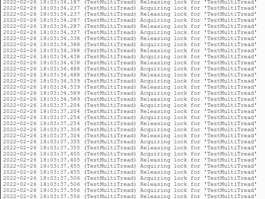

I have the same especially with plugins using Threading. I just tried with the multi-threading example in the domoticz plugin folder, and got the same...

This is known issue in Domoticz 2022.1. The fix has been released in beta channel and people are testing it, see viewtopic.php?t=38086

The changes (i.e. improved inter-thread locking strategy and others) in Python Framework by moving to new Python ABI fixed the cause of those log messages not just logging behavior. You can see in this thread it indeed helped to fix this problem not only for me and my plugin but also for other people using other plugins...
