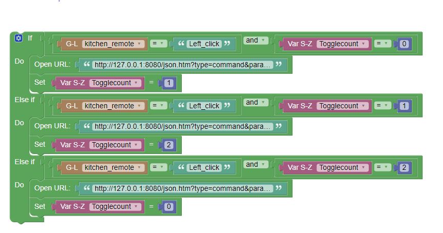

i have an Aqara zigbee wireless wall switch with 2 buttons, in domoticz it shows an an selector switch, in the device manager it shows as only one switch, my plan was to use this aqara switch to control 2 diferent lights but with only one selector switch in domoticz i really dont know how i can use it in blocky.
do you have any suggestions?

This is an example of a blocky with using a selector switch. I hope this is what you are searching for.
Just place a variable in domosettings --> uservariables.
this is the xml to import it:
- blockly.JPG (73.75 KiB) Viewed 5329 times

sorry but i didnt have any luck with this blocky, i made an user variable, like this: 6 toggle switch String [0,1,2] 2019-08-30 23:08:28
i dont know if its right.
but i cant seem to understand where i should ad the light buld that i want to turn on by this aqara switch. in blocky i mean

You have to replace the url part with the light name and add status on or of.
You can use json url to dim a bulb.

i found this: http://127.0.0.1:8080/json.htm?type=com ... cmd=Toggle
works great , thank you all for the help

The toggle count is used for creating a circle which will take it off state when highest number is reached.
This way you can use one button to do more actions. Every toggle count number is another action with one button.
